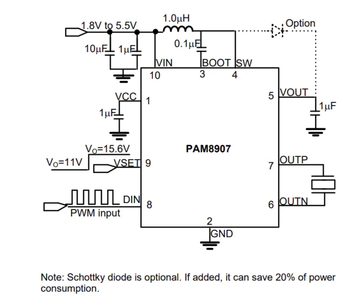

The wide 1.8 V to 5.5 V input voltage range supported by the PAM8907 sounder driver enables it to address a broad variety of potential applications. A 22 VPP or 31 VPP output value can be selected (using the GPIO), thereby providing two different SPL options which allow optimized performance for SPL or battery runtime. Its integrated boost converter requires only a 1.0 µH external inductor which helps reduce the bill-of-materials costs and board space.

Typical Application
