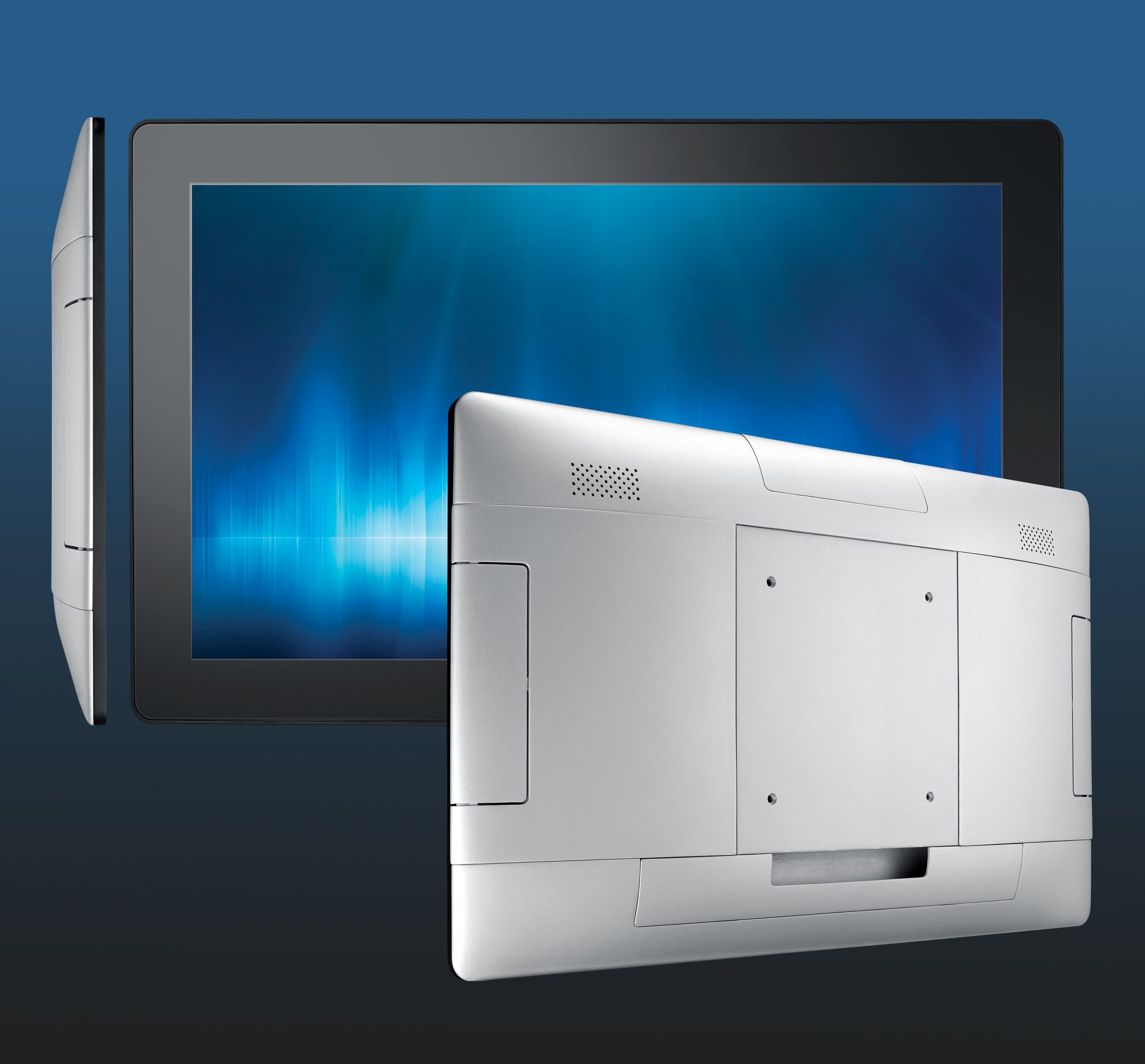

UTC-115 features a durable plastic exterior, widescreen touch display, and lightweight components. With a thickness of just 29.5 mm, Advantech’s UTC-115 touch computer is one of the thinnest products of its type, enabling easy installation, integration, and maintenance in public spaces. This machine combines powerful 24/7 performance with a thin form-factor package for applications in diverse retail environments.
Featuring two Gigabit Ethernet, two COM, four USB 3.0, one HDMI, and one audio connector, UTC-115’s minimalist design offers only essential I/Os. The system’s easy installation, adaptable I/Os, and expansion support makes Advantech’s UTC-115 an ideal choice for retail applications.

Advantech’s UTC-100 series supports multiple installation methods, substantially expanding system adaptability. Equipped with a 100×100 VESA mount and easy cabling design, it supports portrait and landscape screen orientations. Additionally, modularized peripherals can be installed on four sides of the computer to accommodate unique requirements. Featured peripherals include an RFID reader, 5M camera, smart card reader, magnetic strip reader, 1D /2D barcode scanner, and LED light bar for value-added functionality. UTC-100 family features a three sectional I/O, enabling secure connections while concealing cords for reliability and safety.
Advantech’s UTC-100 series supports a wide voltage range (12 ~ 24V) to accommodate various power supply considerations.
