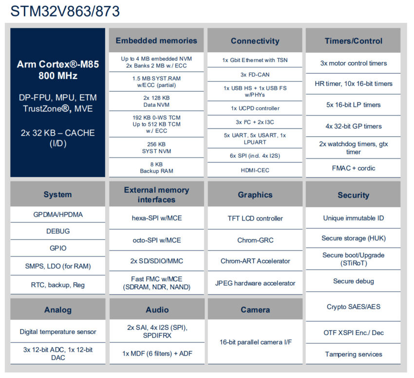

The STM32V863/873 integrates up to 4 MB eNVM, 1.5 MB ECC SRAM, zero-wait-state TCM, a Chrom-ART 2D GPU, JPEG acceleration, LCD-TFT output, and a parallel camera interface. Additionally, it integrates Gigabit Ethernet with TSN, USB HS/FS with PHYs, I3C/I2C/UART/SPI peripherals, 12-bit ADC/DAC, motor-control timers, GPDMA/HPDMA, and security blocks such as TrustZone, secure storage, SAES/AES, and anti-tampering, among others.
STM32V8/STM32V863 Block Diagram
