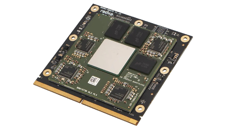

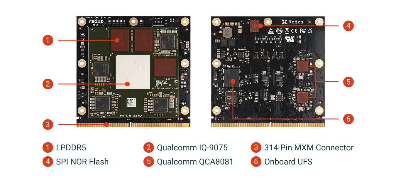

Radxa has expanded its embedded portfolio with the VMARC-Q9075, a high-performance Qualcomm Dragonwing compute module built around the Dragonwing IQ-9075 platform. The SMARC-format module measures 82 × 80mm and targets edge AI, robotics, machine vision, and industrial applications that need substantial compute performance in a compact design.

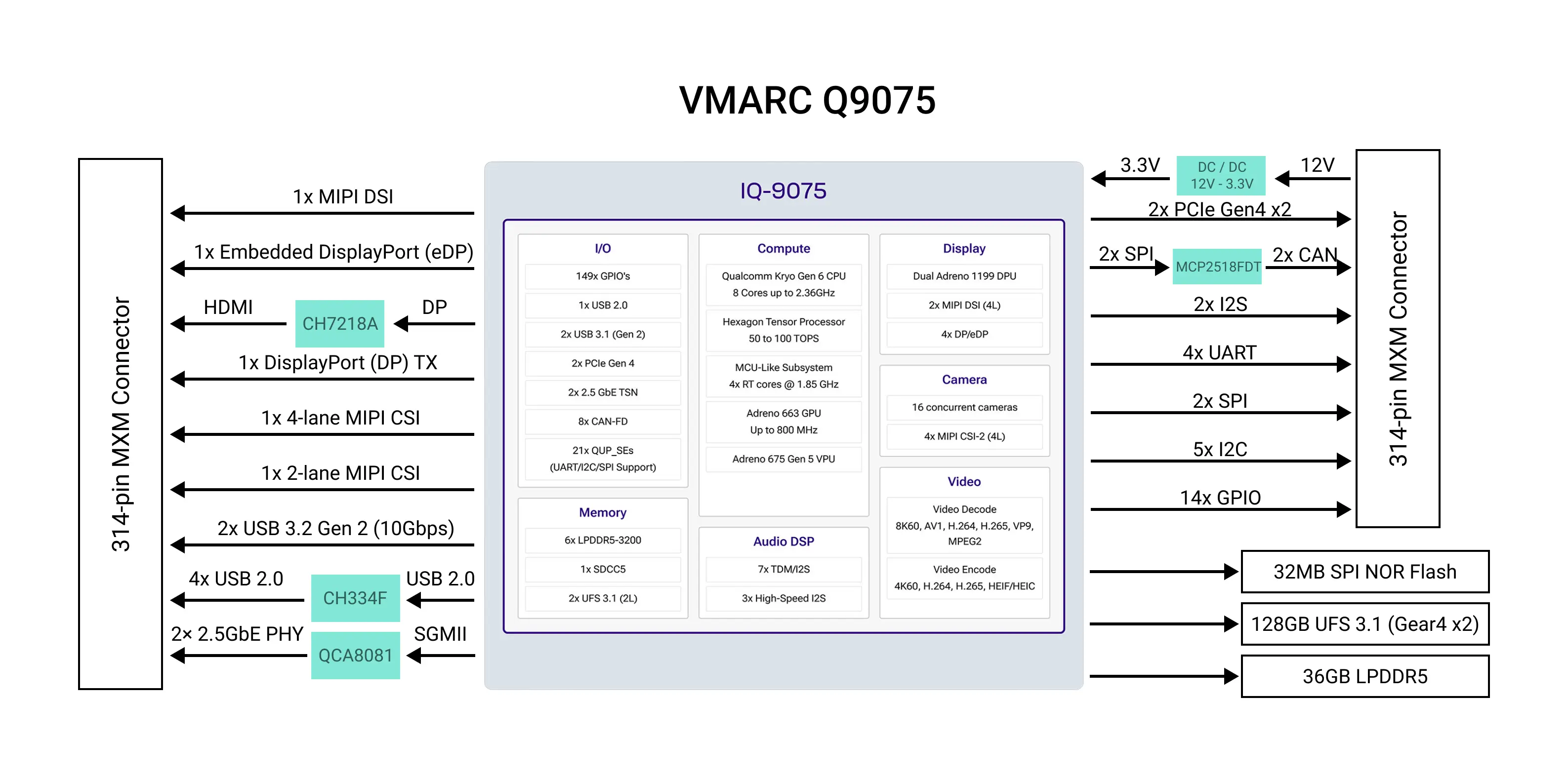

The VMARC-Q9075 combines an eight-core Kryo Gen 6 CPU running at up to 2.36GHz with an Adreno 663 GPU and a Hexagon Tensor Processor capable of up to 200 Sparse TOPS of INT8 AI performance. It also integrates 36GB of LPDDR5 memory, 128GB of UFS 3.1 storage, and a four-core Cortex-R52 MCU for real-time control workloads.
VMARC-Q9075 block diagram

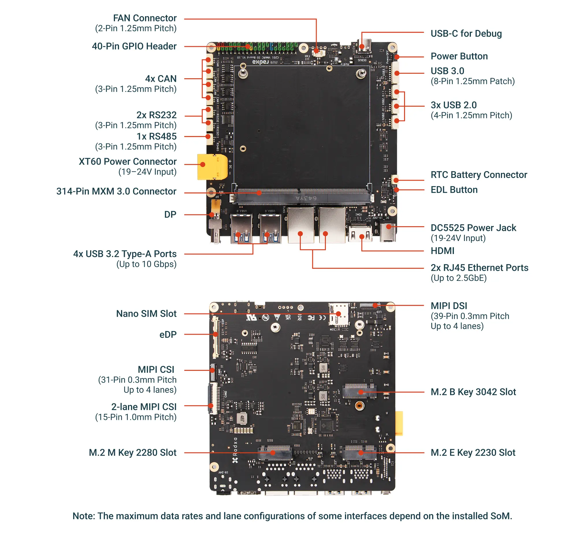

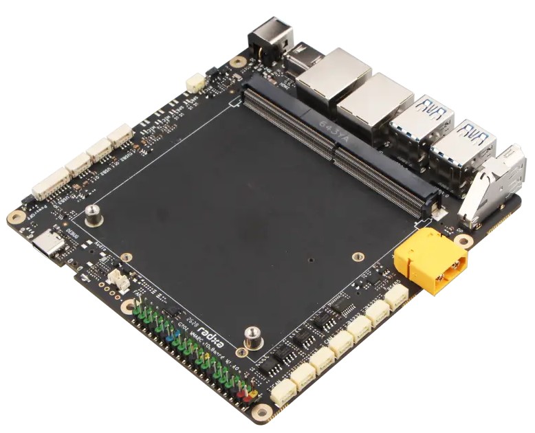

For development and system integration, Radxa pairs the module with the C201 carrier board. The 120 × 120mm board exposes the VMARC-Q9075 interfaces through dual 2.5GbE, an M.2 M-Key slot for NVMe SSDs, Wi-Fi/Bluetooth and cellular expansion slots, HDMI, DisplayPort, eDP, dual MIPI CSI, four USB 3.2 ports, RS-232, RS-485, four CAN connectors, and a 40-pin GPIO header. It accepts 19–24V input through a DC5525 jack or XT60 connector.
C201 carrier board
C201 carrier board Specifications:
  • SoM Compatibility:
    • Supports Radxa VMARC-Q9075 compute module
    • 314-pin MXM 3.0 connector
  • Storage:
    • 1× M.2 M-Key 2280 slot
    • Supports NVMe SSDs
  • Networking:
    • 2× RJ45 Ethernet ports, up to 2.5GbE
    • 1× M.2 E-Key 2230 slot for Wi-Fi/Bluetooth
    • 1× M.2 B-Key 3042 slot for cellular modem
    • 1× Nano-SIM slot
  • Display:
    • 1× 4-lane MIPI DSI interface
    • 1× eDP interface
    • 1× HDMI Type-A port
    • 1× DisplayPort interface
  • Camera:
    • 1× 31-pin MIPI CSI interface, up to 4 lanes
    • 1× 15-pin MIPI CSI interface, up to 2 lanes
  • USB:
    • 4× USB 3.2 Type-A ports, up to 10Gbps
    • 1× USB 3.2 header, up to 10Gbps
    • 3× USB 2.0 headers
    • 1× USB Type-C debug port
  • Industrial and Peripheral I/O:
    • 4× CAN bus connectors
    • 2× RS-232 ports
    • 1× RS-485 port
    • 1× 40-pin GPIO header with UART, SPI, I2C, and GPIO
    • 1× power button
    • 1× EDL button
    • 1× 2-pin 1.25mm fan connector
    • 1× RTC battery connector
  • Power:
    • DC5525 barrel jack
    • XT60 connector
    • 19–24V DC input
  • Dimensions: 120 × 120mm carrier board
