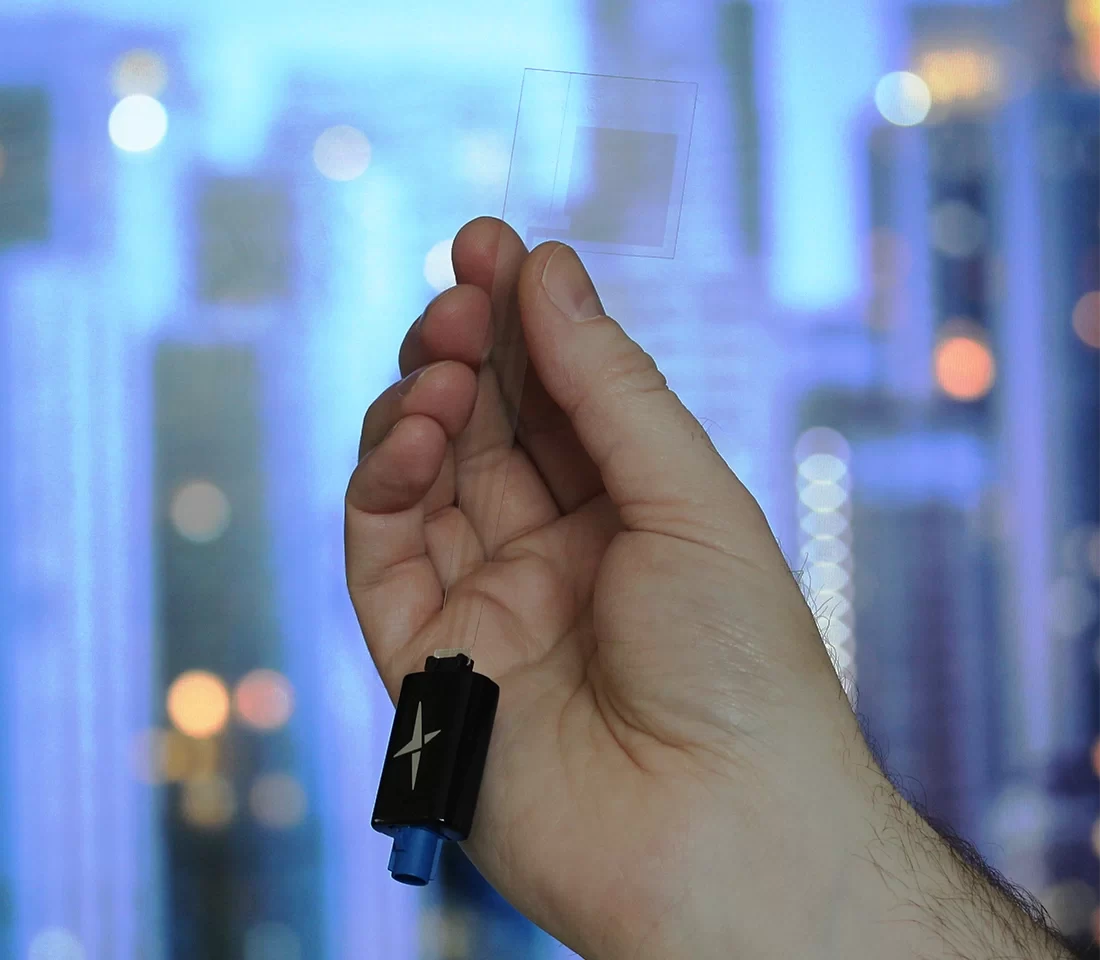

Taoglas®, a trusted provider of antennas and IoT components that helps solve complex engineering problems, announces three new invisible antennas supporting cellular, Wi-Fi, and GNSS technologies. With simple “peel and stick” mounting to any nonmetal surface such as plastic, glass, and screens, the paper thin, ultra-lightweight TFX series offers a clear alternative to standard opaque antennas for use in mobility, public infrastructure, medical devices, transportation, and emerging IoT applications.
The TFX62.A, TFX257.A, and TFX125.A can be used standalone or in a custom combination to enhance cellular, Wi-Fi, and GNSS antenna installations respectively. Each antenna comes with an adhesive applied and has an enclosed carrier terminated with a FAKRA connector for easy installation. The new series leverages a sub-mm thick hybrid transparent conductive film that offers designers an invisible antenna solution with the performance, reliability, and form factors of opaque antennas.
