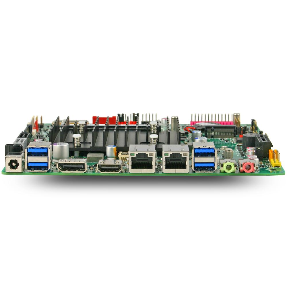

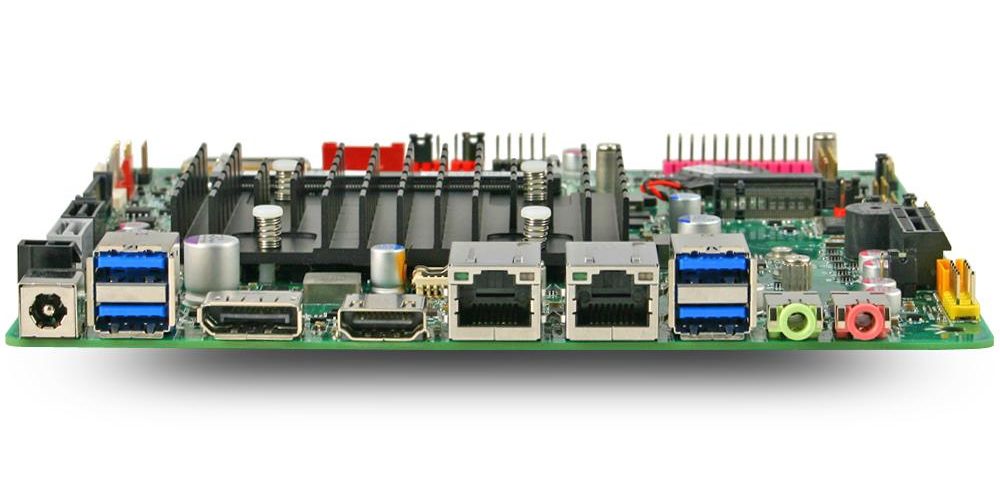

With the PD10AI, ICP Deutschland launches a Thin Mini ITX Board that supports system integrators in two ways. The first is the low height of the board, which is required for particularly compact systems. On the other hand by the design of the board, which allows the certification according to EMV/FCC class B.
The PD10AI is equipped as standard with the Intel® Celeron® N3350 Dual Core processor, which supports a burst frequency of 2.4GHz. Optionally, a version with Quad Core Intel® Pentium® N4200 with 2.5GHz burst frequency is available. Both versions support up to 8GB DDR3L SO-DIMM memory with a maximum clock rate of 1867MHz. The internal Intel® HD graphics unit provides triple display support. A 4K HDMI with max. 3840×2160 resolution, a 4K display port with max. 4096×2160 resolution and a Full HD LVDS connector with max. 1920×1200 resolution are available. The LVDS connector can optionally be replaced by a 4K embedded display port with max. 3840×2160 resolution.

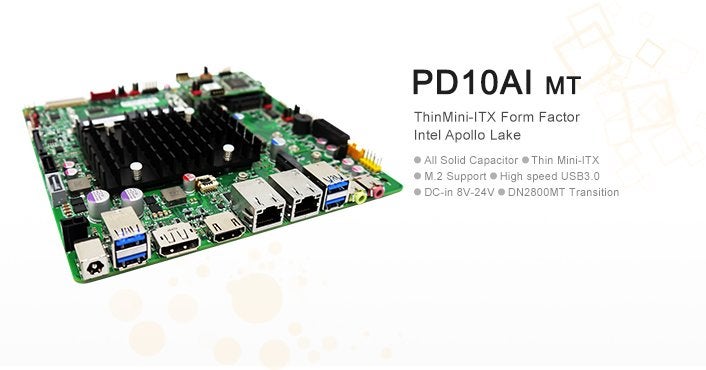

The specifications:
  • Thin-Mini-ITX Form Factor
  • Intel® Celeron® N3350 or Pentium® N4200 Processor
  • Intel® H310/Q370 chipset
  • Max. 8GB DDR3L SO-DIMM RAM
  • Triple Display Support
  • 2x M.2, 1x PCIe x1 (Gen. 3)
  • Intel® GbE Ethernet, USB, HDMI, DP, LVDS/eDP,
  • Configurable RS-232/422/485
  • Designed for EMC class B
