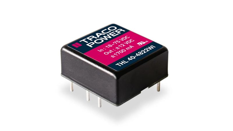

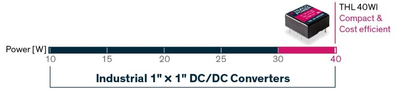

In the realm of power electronics, the continuous push for higher power density and robust performance in a compact footprint remains a constant challenge. Traco Power’s new THL 40WI series addresses this challenge with the introduction of 40 W DC/DC converters housed in a 1-inch x 1-inch x 0.43-inch metal package. This form factor is designed for applications where board space is at a premium, without compromising on performance or reliability.
Traco Power has focused the design of its new THL 40WI series of 40 W DC/DC converters on cost efficiency and quality
Traco Power has focused the design of its new THL 40WI series of 40 W DC/DC converters on cost efficiency and quality. Image used courtesy Traco Power

A compact, 1-inch x 1-inch x 0.43-inch metal housing and generous temperature tolerance of -40 to 65 °C make the THL 40WI series suitable for a wide range of applications
A compact, 1-inch x 1-inch x 0.43-inch metal housing and generous temperature tolerance of -40 to 65 °C make the THL 40WI series suitable for a wide range of applications. Image used courtesy of Traco Power

Cost-Efficient Power Conversion
The THL 40WI converters are positioned for a range of applications, including mobile equipment, instrumentation, communication systems, and general industrial electronics. The series meets the latest IT safety certifications (UL 62368-1), which streamlines the process for engineers working on projects that require compliance with international safety standards.
The combination of its compact size, wide input voltage range, and robust thermal performance makes the THL 40WI 40 W DC/DC converters a relevant component for engineers seeking to design cost-efficient yet high-quality power solutions.
