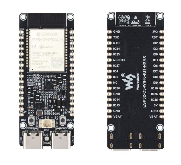

Waveshare has introduced the ESP32-C5 Development board, a compact development platform built around the ESP32-C5-WROOM-1 module for IoT gateways, smart home hubs, and multi-protocol wireless applications. The board targets developers looking for a flexible wireless solution that combines Wi-Fi 6, Bluetooth LE, Zigbee, and Thread support on a single RISC-V platform.
The board uses the Espressif ESP32-C5 SoC, a single-core 32-bit RISC-V processor running at up to 240MHz. It integrates 384KB SRAM, 320KB ROM, and 8MB PSRAM, while offering 16MB or 32MB SPI flash options depending on the variant. Waveshare also provides versions with either a built-in PCB antenna or an external dual-band Wi-Fi antenna for improved wireless coverage.

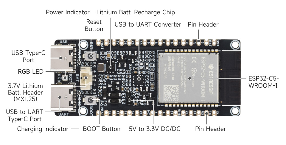

ESP32-C5 Development Board Top and Bottom
ESP32-C5-WIFI6-KIT Development Board Top and Bottom

  • Other features: RGB LED, Boot and Reset buttons, power LEDs, and current measurement jumper
  • Power input:
    • 5V USB-C, 5V GPIO input, or 3.3V input
    • Battery support: Onboard charging circuit with 3.7V lithium battery connector

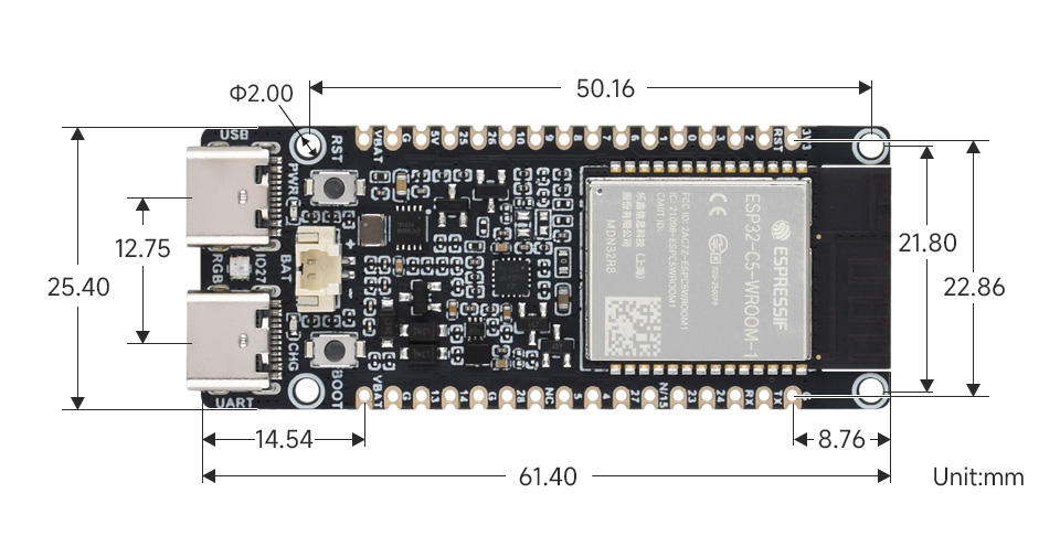

  • Dimensions: 61.4 × 25.4 mm

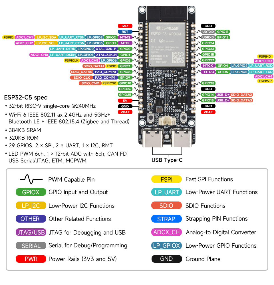

ESP32-C5-WIFI6-KIT pinout diagram

ESP32-C5-WIFI6-KIT dimentions
ESP32-C5-WIFI6-KIT dimensions
