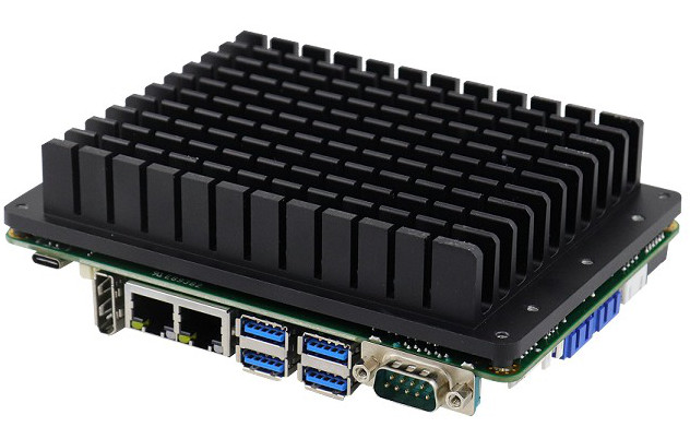

IBASE Technology, a global provider of Industrial motherboards and embedded computing solutions, reveals the IB919 3.5-inch single board computer based on 8th Generation Intel® Core™ i7/i5/i3 and Celeron® 4000 processors (codenamed Whiskey Lake-U) built on a further refined 14nm++ manufacturing process, offering greater computing and graphics performance than the previous generation. IBASE expands its portfolio of long-term available products with the launch of the IB919 3.5-inch SBC equipped with USB Type-C, 9V~24V wide-range DC input and optimized Thermal Design Power (TDP) of 15W that allows designers to configure systems with performance and low-power requirements.
“We are pleased with Intel’s long-term supply commitment for the Whiskey Lake-U platform, enabling us to back up the new IB919 SBC with a 15-year life cycle,” said Wilson Lin, Director of IBASE Product Planning Department. “The guaranteed availability ideally fits customer demands for their current and upcoming programs in smart retail, transportation, healthcare, and smart factory applications even in large field deployments.”
The IB919 comes in two series, the IB919AF (Core™ i7-8665UE, i5-8365UE) and IB919EF (i3-8145UE, Celeron 4305UE), both of which feature up to 32GB DDR4-2400 memory in dual channel and dual Intel Gigabit Ethernet. The board drives up to three independent displays with two DisplayPort (DP & Type C) and eDP or 24-bit dual-channel LVDS interface. Peripheral and external connections are made with a wide selection of interface via two M.2 slots (M2280 & E2230) for NVMe drives and CNVi wireless connectivity, four COM, two SATA III, four USB 3.1 Gen2 (10Gb/s), two USB 2.0 and a USB Type-C connector.

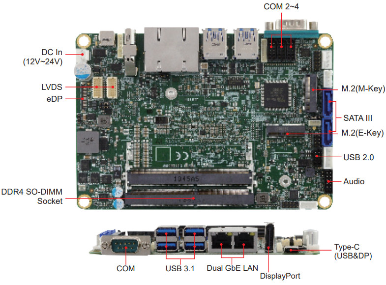

IB919 FEATURES:
  • Onboard 8th Gen Intel® Core™ i7/i5/i3 / Celeron® processor
  • 2x DDR4-2400 SO-DIMM, Max.32GB, Non-ECC
  • 2x DisplayPort (via DP & Type-C)
  • 1x eDP or 24-bit dual-channel LVDS display output
  • 2x Intel® PCI-E GbE LAN
  • Watchdog timer, Digital I/O, TPM (2.0)
  • 2x USB 2.0, 4x USB 3.1 (Type-A), 1x USB (Type-C), 2x SATA III
  • 2x M.2 socket (M/E key)
Specifications listed for the IB919 include:
  • Processor — Intel 8th Gen “Whiskey Lake” UE-series Core and Celeron (2x or 4x core @ up to 2.0GHz); Intel UHD Graphics 620 (Gen 9.5 HD Graphics with 24 EU); 15W TDP (configurable TDP of 12.5W to 25W)
  • Memory — up to 32GB of 2400MHz DDR4
  • Storage – 2x SATA III; M.2 M-Key 2280 with NVMe support
  • Networking — 2x Gigabit Ethernet ports (PCIe with Intel I219LM (model AF) or I219V (model EF) with I211AT)
  • Display/media:
    • 2x DisplayPort (DP and via USB Type-C)
    • eDP and/or LVDS
    • Triple independent display support
    • Audio I/O (Realtek ALC269 HD audio) with class-D amp
  • Other I/O:
    • 4x USB 3.1 Gen 2 host ports at up to 10Gbps
    • USB 3.1 Type-C port with USB and DP support
    • 2x USB 2.0
    • RS232/422/485 port
    • 3x RS232
    • 4-in, 4-out DIO
  • Expansion:
    • M.2 M-Key 2280 slot with NVMe support (see storage above)
    • M.2 E-Key 2230 slot with CNVi support
  • Other features — Watchdog; HW monitoring; TPM 2.0, 15-year availability; iAMT 11.6 only on AF models; optional heatsink and cable kit
  • Power — 9-24V DC input and 24V input; consumes 2.24 to 2.25A at 12V with 16GB
  • Operating temperatures — 0 to 60°C; 90% humidity (non-condensing at 60°C)
  • Dimensions — 147 x 102mm (“3.5-inch form factor”)
  • Operating system — Ubuntu Linux or Windows 10
