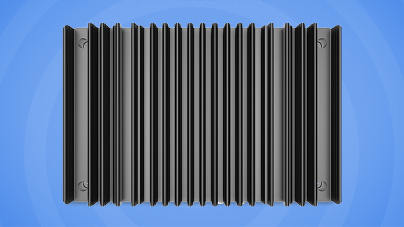

Maca 2 Long Range Wireless Radio Link

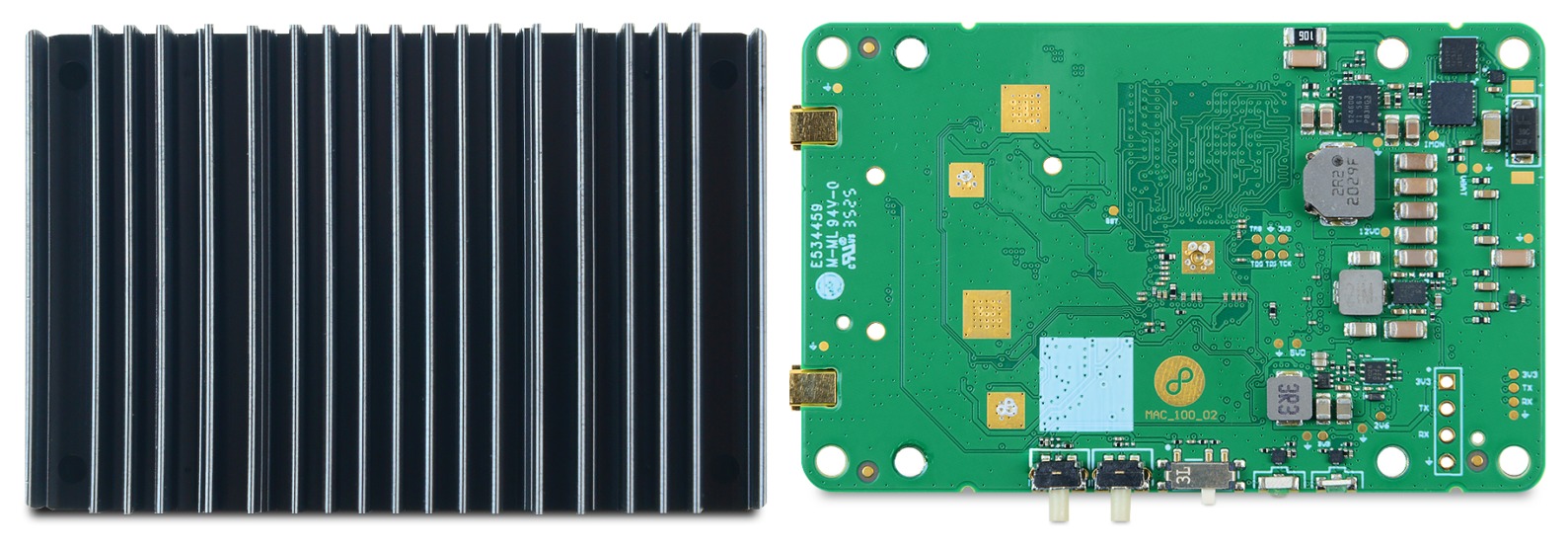

Maca 2 Long Range Wireless Radio Link Top and Inside PCB
Maca 2 Top and PCB

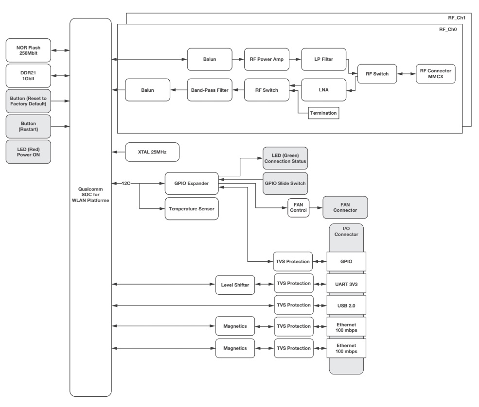

8devices Maca 2 Block DIagram
The Maca 2 has an embedded Linux operating system (Robosoft) pre-installed on it, which provides configuration, spectrum management, and system monitoring for the Maca 2 via graphical and command line interfaces. The Maca 2 can also incorporate Meshmerize for its networking capabilities (e.g., multi-path routing and traffic prioritization) on the Maca-M variant, allowing a network of drones/robots to automatically determine the best path for data without needing to be manually programmed to do so.
