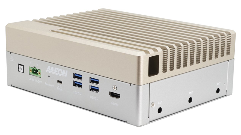

BOXER-8742AI Embedded Box PC Rear View

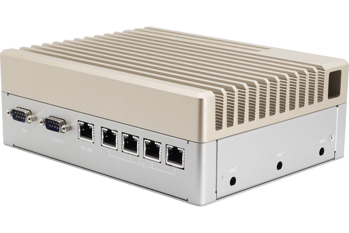

BOXER-8742AI Fanless Embedded Box PC Rear View
BOXER-8742AI Specifications:
  • AI accelerator: NVIDIA Jetson T4000 (Jetson Thor platform)
  • CPU: 12-core Arm Neoverse-V3AE 64-bit processor
  • GPU: 1,536-core NVIDIA Blackwell GPU with 64 fifth-gen Tensor Cores
  • AI performance: Up to 1200 TFLOPS
  • Memory: 64GB 256-bit LPDDR5X
  • Storage: 1× M.2 2280 M-Key (NVMe SSD)
  • Display: 1× HDMI 2.0
  • Ethernet: 1× 5GbE RJ45, 4× 1GbE RJ45 with PoE (802.3af/at, 60W max)
  • USB: 4× USB 3.2 Gen 2 Type-A
  • Serial and field I/O:
    • 1× DB-15 (RS-232/422/485 + 8× DIO)
    • 1× DB-9 (RS-232 + 2× CAN FD)
  • Wireless expansion:
    • 1× M.2 3042/3052 B-Key (4G/5G, USB 3.0 + PCIe)
    • 1× M.2 2230 E-Key (Wi-Fi / Bluetooth / NVMe)
  • SIM: 2× SIM slots
  • Antenna: 6× external SMA connectors
  • Expansion (storage): 1× M.2 2280 M-Key (NVMe)
  • Misc:
    • Recovery Button x 1
    • Reset Button x 1
    • Power Button x 1
  • Power input: 12–24V DC via 2-pin Phoenix connector
  • Dimensions: 210 × 164.2 × 74 mm
  • Operating temperature: −25°C to 60°C (with 0.7 m/s airflow)
  • Storage Temperature: -40°F – 185°F (-40°C ~ 85°C), non operation
  • Storage Humidity 5%~ 95% @ 40°C, non-condensing
  • Anti-Vibration: 3.5G / 5~500Hz / operating
  • Anti-Shock: 50G peak acceleration ( 11 msec.)
  • Certifications: CE, FCC Class A
