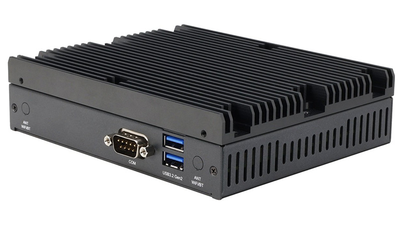

AAEON Intelli TWL01 Edge industrial mini-PC
The AAEON Intelli TWL01 Edge is a mini-PC for industrial use, supporting dual 4K displays and powered by an Alder Lake-N/Twin Lake processor up to the Intel Core 3 N355 CPU. The mini-PC is designed for kiosks, video conferencing suites, video walls and interactive billboards. The rugged design of the IPC makes it an ideal choice for high-vibration environments, such as the floor of a manufacturing plant, and commercial applications, such as a customer interfacing kiosk.
Dual 4K monitor connections (HDMI 2.0b x 2) for high resolution data display. The fanless computer includes up to 16GB of RAM and 64GB of eMMC flash storage, M.2 sockets for NVMe storage and Wi-Fi/Bluetooth, two Gigabit Ethernet ports, four USB 3.2 ports, an RS-232/422/485 COM port, and more.

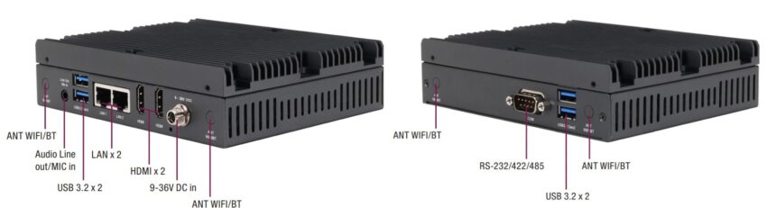

AAEON Intelli TWL01 Edge back side
AAEON Intelli TWL01 Edge Specifications:
  • Processor Options (Alder Lake-N / Twin Lake SoC):
    • Intel Processor N97, quad-core, up to 3.6 GHz (Turbo), 6MB cache, 24EU Intel UHD Graphics @ 1.2 GHz, 12W TDP
    • Intel Processor N150, quad-core, up to 3.6 GHz (Turbo), 6MB cache, 24EU Intel UHD Graphics @ 1.0 GHz, 6W TDP
    • Intel Processor N250, quad-core, up to 3.8 GHz (Turbo), 6MB cache, 32EU Intel UHD Graphics @ 1.25 GHz, 6W TDP
    • Intel Core 3 N355, octa-core, up to 3.9 GHz (Turbo), 6MB cache, 32EU Intel UHD Graphics @ 1.35 GHz, 15W TDP
  • Memory: Up to 16GB LPDDR5
  • Storage:
    • 64GB eMMC onboard (128GB optional)
    • M.2 2280 M-Key slot for NVMe SSD
  • Display and Graphics:
    • Dual HDMI 2.0b ports supporting up to 4K output
    • Integrated Intel UHD Graphics
  • Audio:
    • 3.5mm combo jack (Line-out / Mic-in)
    • Digital audio via HDMI
  • Networking:
    • 2× Gigabit Ethernet (RJ45)
    • Optional Wi-Fi and Bluetooth via M.2 2230 E-Key module
    • 4× antenna openings
  • USB and I/O:
    • 4× USB 3.2 Gen2 Type-A ports
    • 1× RS-232/422/485 serial port
  • Expansion:
    • 1× M.2 2280 M-Key (PCIe x2)
    • 1× M.2 2230 E-Key (PCIe x1, USB 2.0)
    • Internal 10-pin GPIO header
  • Security: TPM 2.0 (fTPM standard, optional onboard TPM via BOM)
  • Power:
    • 9V–36V DC input via lockable jack
    • AT / ATX power modes
    • Typical power consumption: 15W to 37W
  • Dimensions: 152 × 124 × 39 mm
  • Weight: 640 g
  • Environmental:
    • Operating temperature: 0°C to 50°C (with 0.5 m/s airflow)
    • Storage temperature: -20°C to 70°C
    • Humidity: 0% to 90% RH (non-condensing)
  • Reliability and Compliance:
    • MTBF: 1,401,514 hours
    • Certifications: CE, FCC Class A, RoHS, REACH
