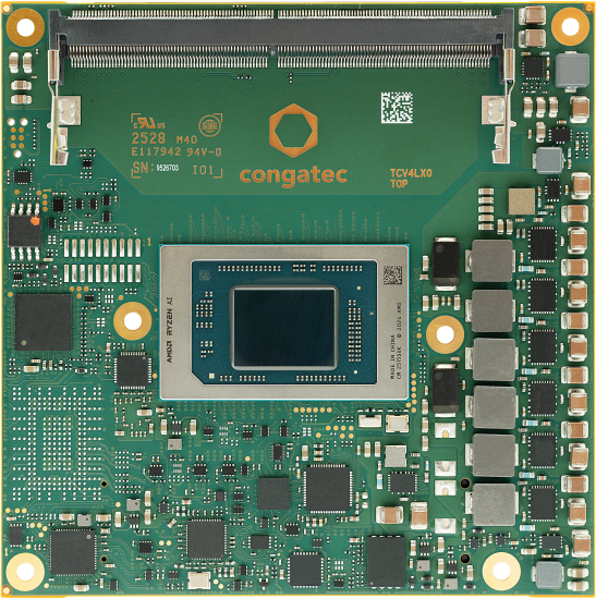

The conga-TCRP1 COM Express compact module is now available with eight, ten, or twelve CPU cores
The conga-TCRP1 COM Express compact module is now available with eight, ten, or twelve CPU cores. Image used courtesy of Congatec
conga-TCRP1: Scalable AMD COM Express Compact Module
The conga-TCRP1 is a COM Express 3.1 Type 6 Compact module based on the AMD Ryzen AI Embedded P100 series. Congatec’s release adds six new variants to the existing lineup, bringing the total processor count to ten options spanning 4 to 12 CPU cores and 2 to 16 GPU compute units. The processors use AMD’s 4-nm “Zen 5” and “Zen 5c” architectures, with boost frequencies reaching 5.1 GHz at the top of the stack.
The integrated XDNA2 NPU delivers up to 50 TOPS of AI compute, and the Radeon RDNA 3.5 GPU supports up to four independent displays. Memory scales to 96 GB of DDR5-5600 RAM with optional ECC. Connectivity includes up to eight configurable PCIe Gen4 lanes, PEG x4 Gen4, four USB 3.2 Gen2 ports, and 2.5 GbE. Storage options include an onboard NVMe SSD up to 512 GB or dual SATA 6 Gb/s drives. All variants cover a configurable TDP window of 15 W to 54 W, with standard (0°C to 60°C) and industrial (-40°C to 85°C) temperature grades available for each configuration.
The module targets compute-intensive applications such as mobile medical imaging, AI-based machine vision, and smart city infrastructure, as well as rugged mission computers. The wide TDP range allows designers to tune the performance-per-watt profile without swapping modules, simplifying product family development under SWaP-C constraints.

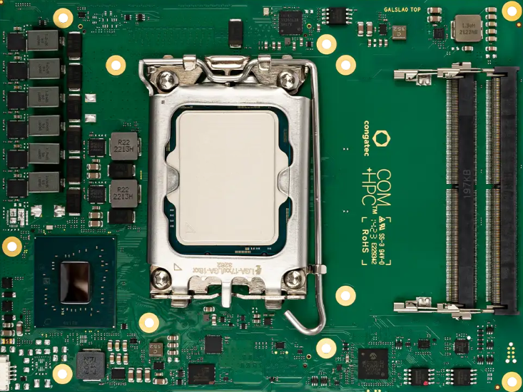

The conga-HPC/cBLCS COM-HPC client platform
The conga-HPC/cBLCS COM-HPC client platform. Image used courtesy of Congatec
conga-HPC/cBLS: Intel P-Core–Only COM-HPC Client Module
The conga-HPC/cBLS is a COM-HPC Client Size C module built around Intel Core Series 2 processors (codename: Bartlett Lake-S). Unlike hybrid-core configurations, this lineup uses only high-performance P-cores (up to 12) with the stated goal of simplifying the development of fully deterministic, low-latency systems. Single-core turbo frequencies reach 5.7 GHz on the top-tier Core 9 273PE, and all three SKUs carry a 65 W base power rating.
The module supports up to 192 GB of ECC-capable memory across four SO-DIMM sockets and provides 42 PCIe lanes for high-bandwidth expansion, including AI accelerator cards. The integrated Intel UHD Graphics (up to 32 execution units) supports Intel Deep Learning Boost and Vector Neural Network Instructions (VNNI) for edge AI inference workloads. Connectivity includes dual 2.5 GbE, four USB 3.2 and four USB 2.0 ports, SATA, UART, GPIO, I2C, and HD audio.
The socketed LGA processor design is intended to support field upgrades, and Congatec positions it as an alternative to traditional motherboards for designs that require regular technology refresh cycles. Target markets include test and measurement, medical imaging, smart grid systems, robotics, and industrial process automation.
