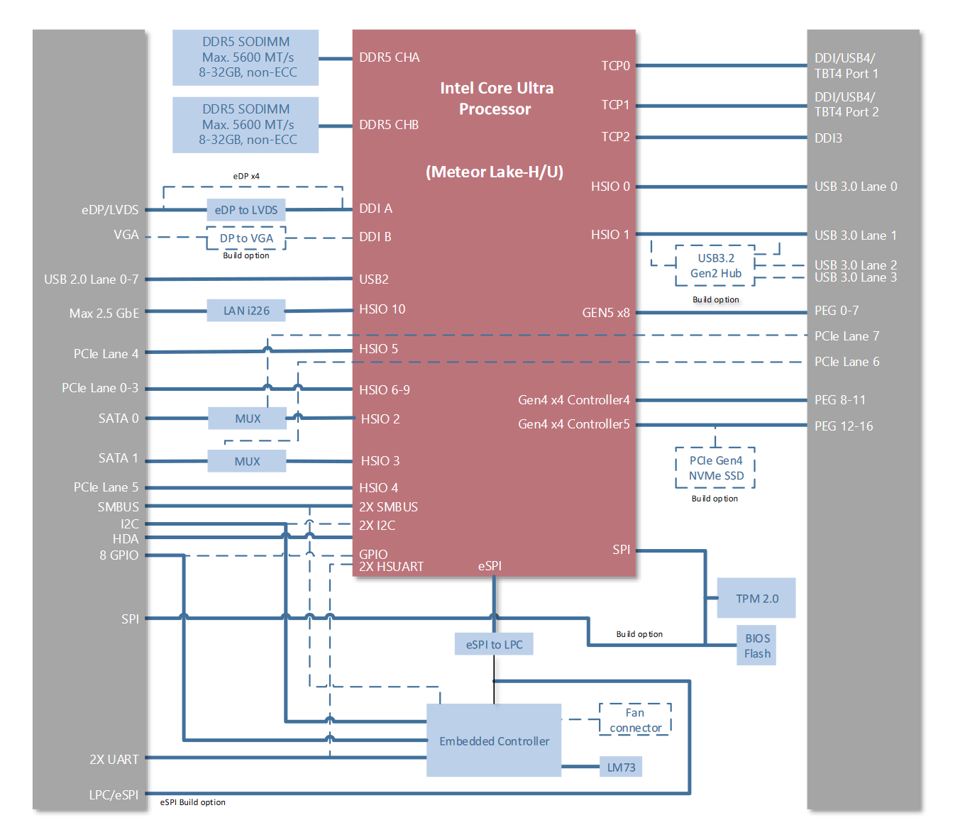

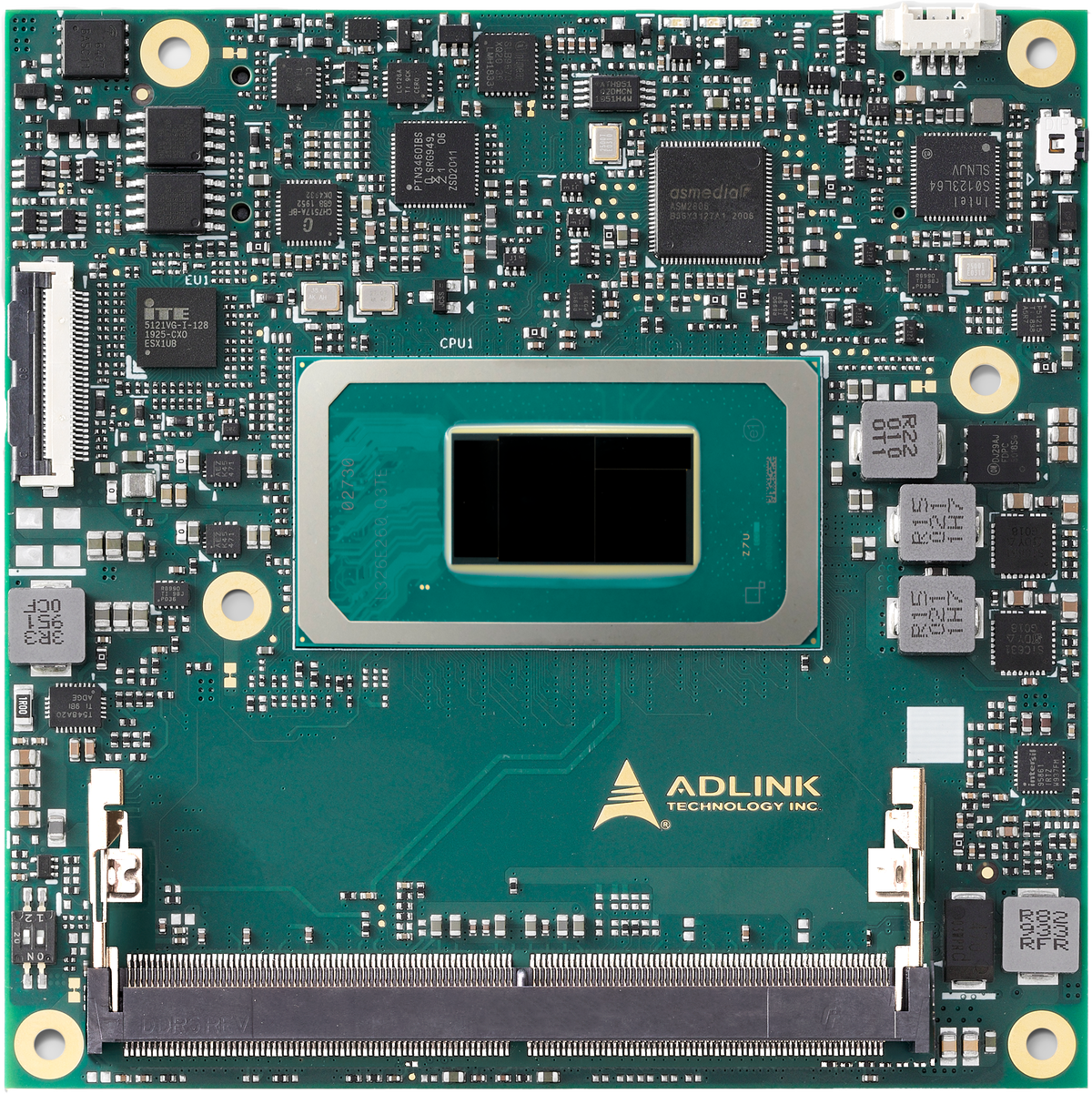

ADLINK Technology Inc., a global leader in edge computing, announces the launch of its cExpress-MTL, a Compact size COM Express Type 6 module powered by the latest Intel Core Ultra processor. Featuring Intel modular architecture that integrates CPU, GPU, and NPU all-in-one for optimized performance and efficiency, the module provides up to 8 GPU Xe-cores (128 EUs), an NPU (11pTOPS/8.2eTOPS), and 14 CPU cores at 28W TDP.

- Intel Core Ultra processor, Intel XeLPG GFX integration and up to 8 Xe -Cores
- New integrated NPU for dedicated AI acceleration
- All PCIe signals upgraded to Gen4
- 2.5GbE Ethernet, with optional TSN
- Up to 64GB DDR5 at 5600MT/s, in-band ECC/non-ECC
- SoC power reduction
- 2x USB4 support (BOM option)
Equipped with hardware-accelerated AV1 encoding and decoding functionality, the ADLINK cExpress-MTL module can also realize instantaneous media streaming with minimal latency. Along with all PCIe interface upgraded to Gen4 for enhanced data transmission and USB4 support for increased flexibility, the ADLINK cExpress-MTL module empowers developers to achieve various graphics- and AI-requiring, battery-powered applications, such as portable medical ultrasound, industrial automation, autonomous driving, AI robots, and more.
