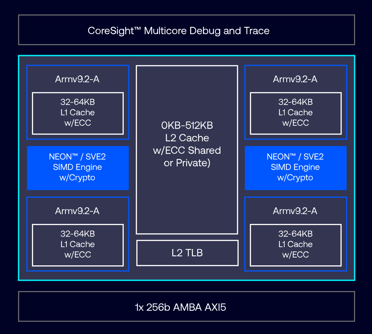

Specifications of the Arm Cortex-A320
  • Architecture
    • Arm9.2-A (Harvard)
  • Extensions
    • Up to Armv8.7 extensions
    • QARMA3 extensions
    • SVE2 extensions
    • Memory Tagging Extensions (MTE) (including Asymmetric MTE)
    • Cryptography extensions
    • RAS extensions
  • Microarchitecture
    • Up to 4x CPUs in cluster
    • 40-bit Physical Addressing (PA)
    • In-order pipeline
    • Partial superscalar support
    • NEON/Floating Point Unit
    • Optional Cryptography Unit
  • Memory system and interface
    • 32KB or 64KB L1 I-Cache / D-Cache
    • Optional L2 Cache – 128KB, 192KB, 256KB, 384KB, or 512KB
    • No L3 Cache
    • ECC Support
    • Bus interfaces – AMBA AXI5
    • No ACP, No Peripheral Port
  • Security
Features and Applications
The Arm Cortex-A320 features an optimized microarchitecture, with a single-issue, in-order CPU and a 32-bit instruction fetch. Its 8-stage pipeline allows for higher frequency points, while the forwarding network reduces power consumption. Also, the processor supports up to 64KB L1 caches and up to 512KB L2 caches, providing fast memory access. Its 256-bit AMBA5 AXI interface supports high-bandwidth memory access, making it suitable for demanding edge AI applications.
The Cortex-A320 offers several features and optimizations that set it apart from other processors. Its design and optimized microarchitecture provide significant improvements in performance and power consumption. The processor’s support for Armv9 architecture, including NEON and SVE2 vector processing technologies, brings advanced ML/AI applications. Additionally, its security features like Secure EL2, MTE, PCA/BTI, and TrustZone with scalable design make it a reliable processor for a wide range of applications.
