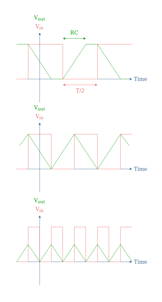

The most important fact to keep in mind from Figure 3 is that a time limitation given by the value R×C exists for the amplifier to switch from one state to the other. In other words, as the frequency increases, and the circuit tends to behave more like a voltage follower, the harder it will be for the op-amp to actually “keep-up”.
We can illustrate this phenomenon with the following Figure 4 showing the output of the integrator when a square signal of period T is applied at its input.
fig 4: Output of the integrator as a function of the input frequency
In the first case, T/2>RC which makes the output to saturate for a while. In the second case, T/2≅RC is the regime where the integrator performs well the integration operation. Finally, when T/2<RC we can see that the integrator cannot efficiently follow the speed rate.

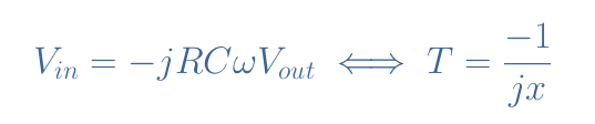

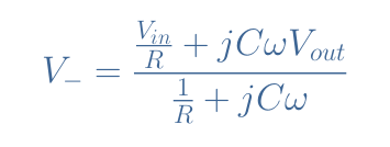

In order to really understand the behavior of the ideal integrator regarding the frequency, we can apply Millman’s theorem to the node N (Figure 1), which gives:
If we suppose the input impedance of the op-amp to be infinite (which is not true but a good approximation), V=0, and therefore:
eq 2: Transfer function of the ideal integrator
With T being the transfer function of the circuit and x=ω/ω00=1/RC). If we convert this data in dB, the gain of the ideal integrator is given by -20log(x), which is a decreasing linear plot G=f(log(x)). The signal phase φ(ω) is here constant and given by the argument of T, since arg(T)=arg(-1)-arg(jx), φ=π-π/2=+π/2.

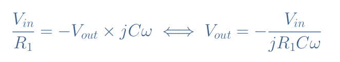

If we suppose the op-amp in Figure 1 to be ideal, the hypothesis i+=i=0 and V+=V=0 are verified due to its infinite input impedance. Therefore, the current across the resistor IR is equal to the current across the capacitor IC.
This current can simply be expressed by I(t)=Vin(t)/R when applying Ohm’s law to the input branch, moreover, we can apply Equation 1 in the feedback loop to write a second expression of the same current: I(t)=-C×(dVout(t)/dt).
Finally, when equalizing the two expressions of I(t), we get the output formula of the integrator op-amp shown in Equation 3. This formula highlights the fact that the output is proportional to the integral of the input signal.
eq 3: Output formula of the integrator op-amp

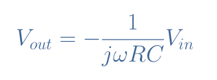

Equation 3 can actually be simplified by using the complex notation:
eq 4: Complex output formula of the integrator op-amp

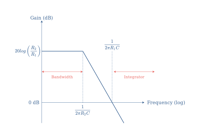

The parameter “x” is here given by ω/ω0 with ω0=1/R2C playing the role of the cutoff frequency at -3 dB. For frequencies from DC up to ω0, T can be approximated to -R2/R1, hence the gain being given by 20log(R2/R1). At ω0 and above, the gain experiences a -20 dB/decade loss, similarly to the ideal integrator, the gain is equal to 0 dB for ω=1/R1C.
As for the phase of the signal, it varies from π when the gain is constant to π/2 when the frequency tends to infinite values.
With this information, the asymptotic Bode plot of the real integrator can be given in Figure 7:
fig 7: Bode plot of the real integrator
As a consequence, we can say that a real integrator behaves as a low pass filter with a cutoff frequency depending on the capacitor and resistor present in the feedback loop.
