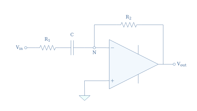

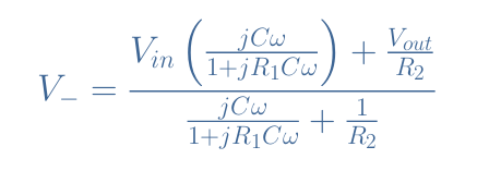

Pseudo-differentiator with a series resistor
An improvement that can be made to the differentiator is to place a series resistor in the input branch. This configuration is referred to as a pseudo-differentiator SR (for series resistor).
fig 6: Pseudo-differentiator SR circuit representation
The equivalent circuit for high frequencies will be an inverting op-amp with a finite gain -R2/R1. As a consequence, in the high-frequency regime, when the capacitor impedance tends to zero, the gain will therefore be limited to R2/R1 instead of ∞ which would make the output to saturate as pinpointed in the ideal circuit section.
We can apply Millman’s theorem at the node N in order to analyze this circuit:
With the virtual earth hypothesis V–=0, we establish the transfer function T of the circuit in Figure 6:
eq 3: Transfer function of the pseudo-differentiator SR
For frequencies from DC up to the cutoff frequency 1/(2πR1C), the transfer function can be approximated to -jR2Cω, which is a similar form of the ideal differentiator transfer function. When the frequency increases and tends to infinite values, a good approximation of the transfer function becomes -R2/R1 which establishes a plateau for the gain.
From these observations, the asymptotic gain Bode plot is given in Figure 7 below, which is typical of a high-pass filter:
fig 7: Bode plot of the pseudo-differentiator SR
We can conclude by saying that the pseudo-differentiator SR is a good approximation of the ideal differentiator up to the cutoff frequency of the circuit determined by the value of R1 and the capacitor C.

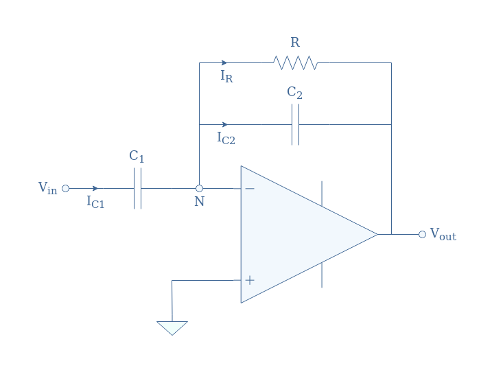

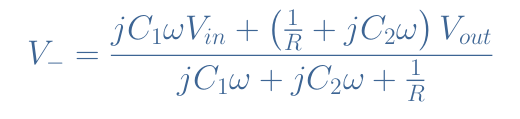

Pseudo-differentiator with a parallel capacitor
Another possible modification that can be applied to the ideal differentiator is to place a capacitor in parallel with the resistor in the feedback loop. The circuit presented in Figure 8 will be referred to as pseudo-differentiator PC (for parallel capacitor).
fig 8: Pseudo-differentiator PC circuit representation
Thanks to the capacitor C2, the equivalent circuit in the high-frequency regime is an inverting voltage buffer which means that the gain will be limited to the unity.
Let’s again apply Millman’s theorem at the node N:
With the hypothesis of the virtual earth, the transfer function T of the pseudo-differentiator PC becomes:
eq 4: Transfer function of the pseudo-differentiator PC

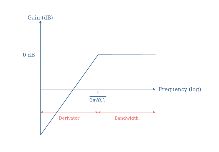

For frequencies from DC up to the cutoff frequency 1/(2πRC2), the transfer function can be approximated to -jRC1ω, which is a similar form of the ideal differentiator transfer function. When the frequency increases and tends to infinite values, the gain of the transfer function reaches a plateau of absolute value 0 dB.
The transfer function of the pseudo-differentiator PC is again equivalent to a first-order high-pass filter such as we show in the following asymptotic Bode plot:
fig 9: Bode plot of the pseudo-differentiator PC
We can conclude by saying that the pseudo-differentiator PC is a good approximation of the ideal differentiator up to the cutoff frequency of the circuit determined by the value of R and the capacitor C2.
