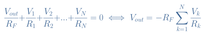

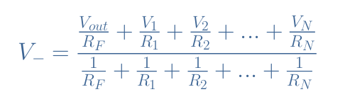

We can apply Millman’s theorem to V– in order to demonstrate the output relation of this circuit:
With the hypothesis of the ideal op-amp, i+=i–=0, and V+=V–=0, which leads to the output relation of the inverting summing amplifier:
eq 1: Output formula of the inverting summing amplifier

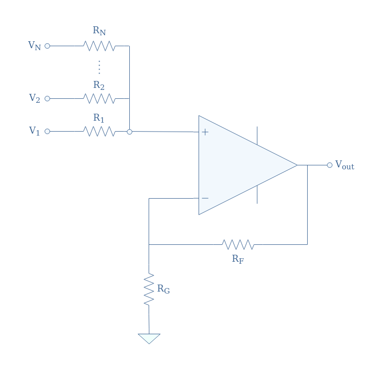

Non-inverting summing amplifier
The non-inverting summing amplifier is a similar configuration to the inverting summing amplifier. However, the inputs here are applied to the non-inverting input while the inverting branch is connected to both the op-amp’s output through a feedback resistor RF and grounded through a resistor RG.
fig 2: Non-inverting summing amplifier circuit representation

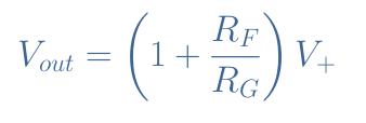

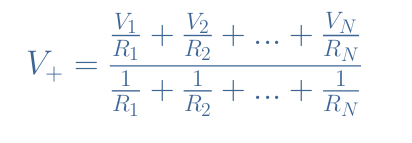

We can apply Millman’s theorem to V+ in order to demonstrate the output relation of this circuit:
Since the voltage gain Vout/Vin=Vout/V+ of a non-inverting configuration is given by 1+(RF/RG), we can conclude that the general relation for the non-inverting summing amplifier output is given by Equation 3:
eq 3: Output formula of the non-inverting summing amplifier
The expression of V+ can be extremely simplified if we pose R=R1=R2=…=RN, we get indeed:
Moreover, we can also pose (1+RF/RG)=N in order to get a direct sum of the input voltages:
eq 4: Simplified output formula with the resistor equality condition
With these two conditions, we can see that the output voltage is a direct sum of the input signals as the sum is not weighted and no phase difference is present.

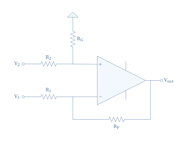

If the inputs are both applied to the inverting and non-inverting pins of an op-amp, a subtracting configuration is realized such as presented in Figure 3:
fig 3: Subtracting amplifier circuit representation
The voltage V+ can be expressed by a voltage divider formula:

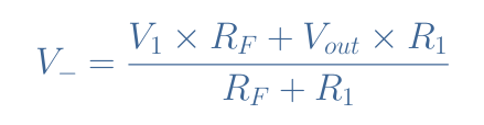

The voltage V– is expressed thanks to Millman’s theorem:

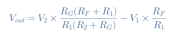

After reminding that V+=V–, a few steps of simplification lead to the general output expression of the subtracting amplifier:
eq 5: Output formula of the subtracting amplifier

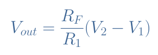

We can simply show by equalizing the two factors that if the condition RFR2=RGR1 is met, the output formula can be simplified to Equation 6:
eq 6: Simplified output formula for the subtracting amplifier
This condition can be achieved by equalizing all the resistances: R1=R2=RG=RF. In that case, since RF=R1, Equation 6 can be reduced to a direct subtraction Vout=V2-V1.

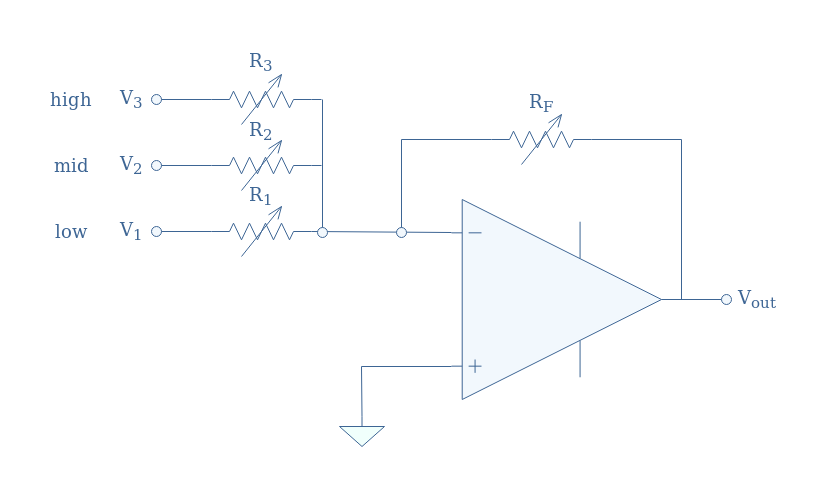

Consider an inverting summing amplifier with three inputs such as presented in Figure 4:
fig 4: Simple audio inverting summing amplifier
The resistors here are replaced by potentiometers in order for a user to directly control the output signal.
This type of configuration can be used in the audio domain where different pitches can be separately processed through an amplifier before being added together with possibly different prefactors.
Typically, the frequency ranges are given by:
  • low: 20 Hz to 500 Hz
  • mid: 500 Hz to 6 kHz
  • high: 6 kHz to 20 kHz

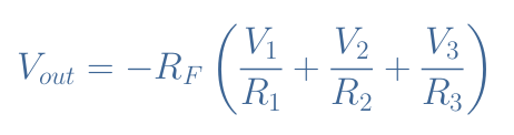

According to Equation 1, the output signal of this configuration is given by:
We can clearly identify that the potentiometer RF controls the global gain of the output, increasing or decreasing its value will simultaneously affect all the frequencies. On another hand, the potentiometers R1, R2, R3 only affect respectively the low, mid, and high pitches and they will enable the user to balance or unbalance certain frequencies.
We can note that if we want the output to be in phase with the different inputs, a simple inverting buffer can be used to rectify it.

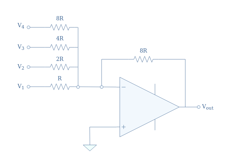

A DAC is a summing amplifier based circuit that converts binary data (0 and 1) into an analog signal (a real number). An example of this circuit with four binary inputs known as a four-bit DAC and is presented in Figure 5:
fig 5: Four-bit DAC circuit representation
The values of the resistor are not chosen randomly, their values always need to double from the previous branch. This ensures a proper conversion from a binary number to a decimal number.

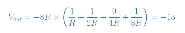

As an example, consider the binary four-bit input 1101 (V1=1 ; V2=1 ; V3=0 ; V4=1). According to Equation 1, the output is given by:
This validity of this result can be confirmed when we manually convert the same input to a decimal number: (1101)decimal=(1×23)+(1×22)+(0×21)+(1×20)=13.
In practice, the circuit shown in Figure 5 can only be implemented up to a certain number of bits depending on the precision of the resistors that must exactly double their value for each added bit. An alternative circuit known as the R-2R Ladder DAC is preferred for higher binary numbers.
