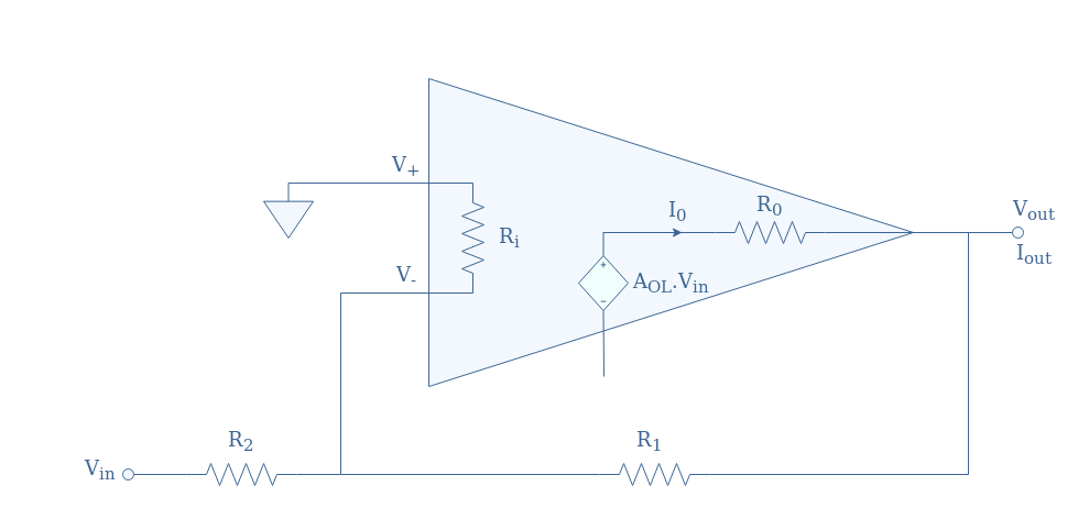

The circuit diagram of a real inverting op-amp is presented in Figure 2:
fig 2: Internal equivalent circuitry of a real inverting op-amp
Such as we had done for the non-inverting configuration, we will now properly demonstrate the formulas for the closed-loop gain, input and output impedances for a real inverting op-amp.
Closed-loop gain
We begin the demonstration of the closed-loop gain by writing that Vout=AOL(V+-V–). Such as mentioned in the first section, the equality V+=0 is still valid because of the ground connection, this implicates that V–=-Vout/AOL.

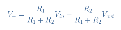

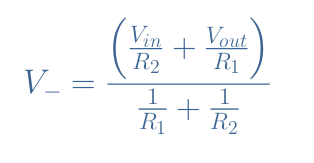

In the non-inverting op-amp, V– could moreover be written as the result of a voltage division by the series configuration R1-R2. However, in the inverting op-amp, V– is rather expressed by a superposition of Vout and Vin:

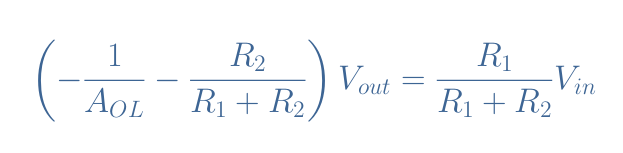

In this formula, we can replace V– by -Vout/AOL, therefore we get:

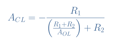

We can finally express the ratio Vout/Vin in Equation 2, which is the definition of the closed-loop gain ACL:
eq 2: Closed-loop gain of a real inverting op-amp
It is interesting to note that if the op-amp approaches its ideal model, AOL→+∞ and therefore Equation 2 can be simplified back to Equation 1.

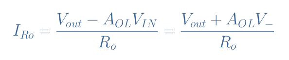

The current IRo across Ro can simply be expressed by performing a Kirchoff’s voltage analysis in the output loop simultaneously with the Ohm’s law formula:
Note that -Vin can be replaced by V– because the non-inverting input is directly connected to the ground.

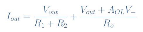

The output current Iout is given by the sum IR1+IRo:

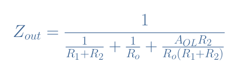

Since V– can simply be expressed by IR1×R1, we can inject this expression in the above formula. After factorizing by Vout every member in the right side of the expression of Iout, we can write the ratio Vout/Iout which defines the output impedance Zout of the configuration:
eq 3: Expression of the output impedance for a real inverting configuration
We can again emphasize that this expression is consistent with the ideal model, indeed when AOL→+∞ we get Zout=0.

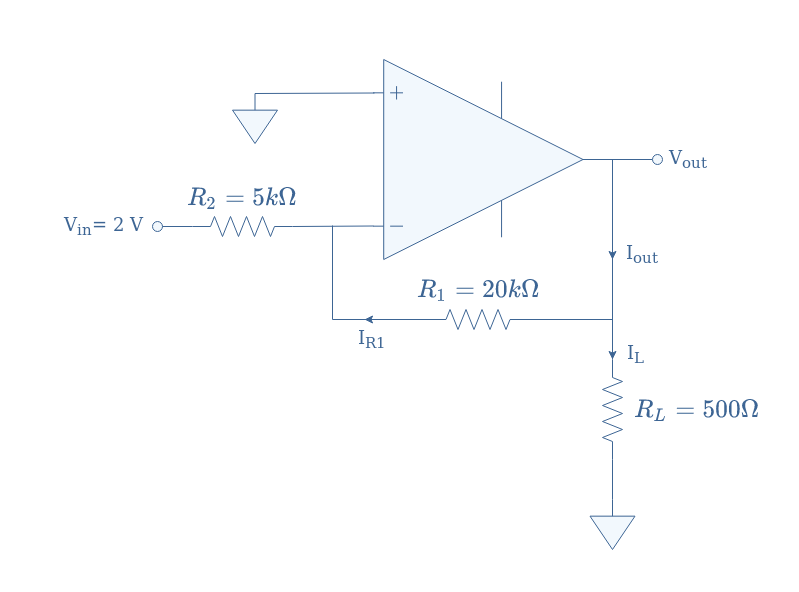

Consider the following inverting configuration presented in Figure 3 for which we will compute the closed-loop gain, input, and output impedances:
fig 3: Example of real inverting configuration
We need to remind that in most of the cases, the open-loop gain AOL is sufficiently high so that the ideal formula can directly be used for the calculation of the closed-loop gain ACL. This value is therefore given here by ACL=-R1/R2=-4.
Since Vin is given to be equal to +2 V, the output voltage is simply Vout=ACL×Vin=-8 V. If we still assume that no current enters through the inverting and non-inverting inputs of the op-amp, the current IR1 across R1 is equal to the current IR2 across R2. This last one is given by Ohm’s law: IR2=Vin/R2=0.4 mA.
The current IL across the output load is also given by Ohm’s law: IL=Vout/RL=-16 mA. By applying Kirchoff’s current law, we see that the output current Iout satisfies IR1=Iout+IL⇒Iout=16.4 mA.
Finally, we can say that the input impedance is given by Zin=R2=5 kΩ, the output impedance is given by Zout=Vout/Iout=490 Ω.
