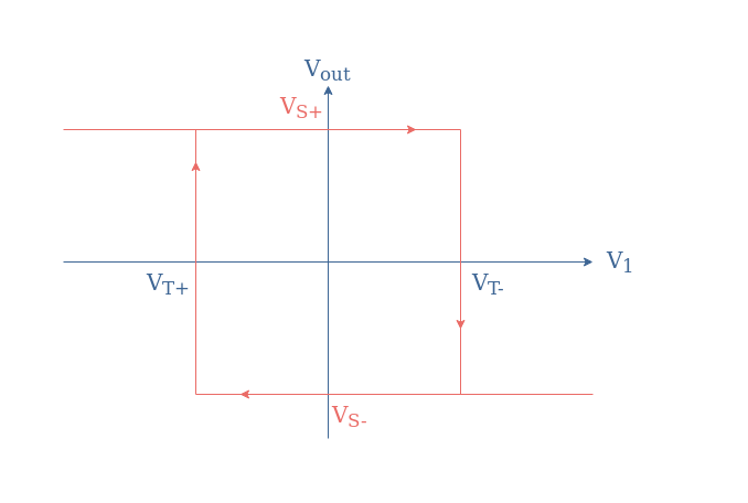

The transfer characteristic of this circuit is a hysteresis plot given by the following Figure 2:
fig 2: Transfer characteristic of the inverting Schmitt trigger
The threshold voltages are always symmetrical (VT-=-VT+) and given by:
  • VT+=-VS(R1/(R1+R2))=-βVS
  • VT-=+VS(R1/(R1+R2))=+βVS
With β=R1/(R1+R2) known as the feedback fraction provided by the voltage divider circuit. The supplying voltages VS+ and VS- can be assimilated to the saturation voltages of the op-amp.
As we can see from Figure 2, if the input signal V1 reaches or exceeds the threshold voltage VT-, the output will negatively saturate. After that, if the input decreases down to the threshold voltage VT+, the output will switch to its positive saturation level.

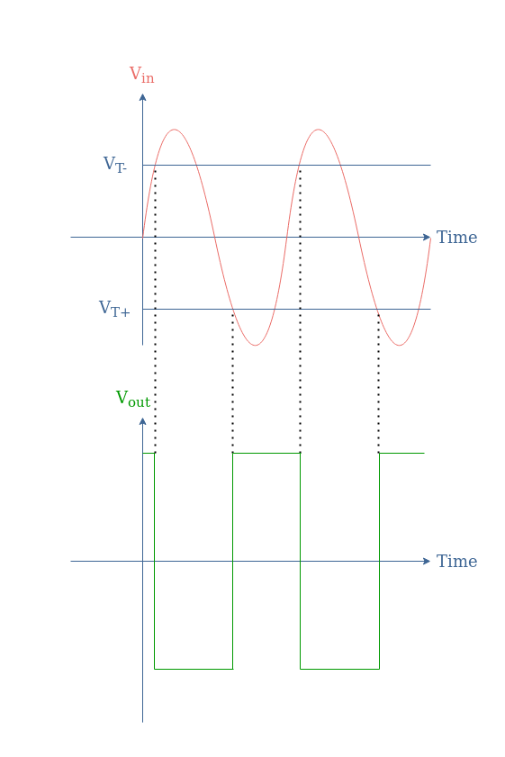

We show in Figure 3 how a sinusoidal waveform would be converted by the Schmitt trigger:
fig 3: Sinusoidal to rectangular signal conversion
It is interesting to note that the period of the output and input signals match, regardless of the position of the threshold voltages as long the amplitude of the input signal is higher than the threshold value.

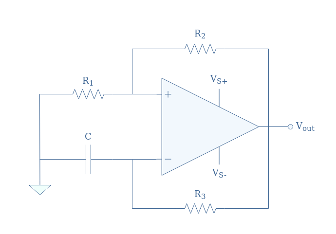

An op-amp based astable multivibrator circuit is presented in Figure 4:
fig 4: Astable multivibrator circuit representation
As mentioned in the introduction section, we can see that in this example of an astable multivibrator, no external input signal is present as both inverting and non-inverting pins are indirectly wired to the ground. Instead, as we will detail during this section, the triggering signal will be provided by the charge/discharge cycles of the capacitor present at the inverting input.
The functioning of the astable multivibrator is quite simple, as when V+>V–, the output saturates in positive values and when V+<V–, the output saturates in negative values.
If we set an origin of time where the capacitor is fully discharged, the inequality V+>V– is respected and as long as this condition is valid, the capacitor is charged through the resistor R3. After a certain time, the charge of the capacitor is high enough so that the voltage produced across it exceeds V+, we obtain therefore the inequality V+<V–. Finally, the capacitor begins to discharge until the first inequality is satisfied again, the circuit will continue to oscillate permanently between these two states, thus the label “astable”.

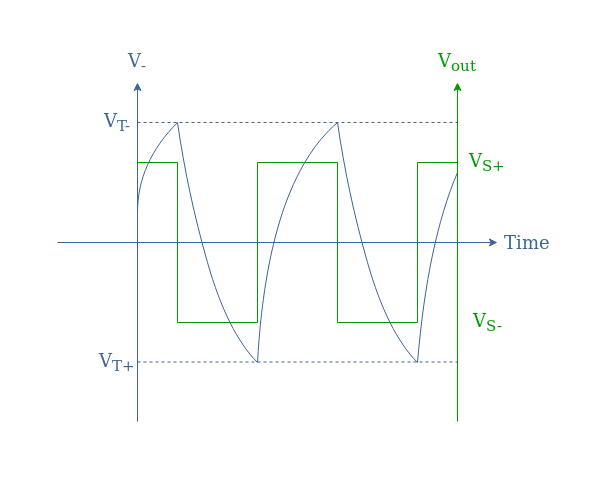

To illustrate this behavior, a chronogram of V– (the capacitor voltage) and Vout is presented in Figure 5:
fig 5: Input/output chronogram of the astable multivibrator
The sawtooth shape for the voltage V– is typical for a capacitor that charges and discharges by following laws of the form:
  • V–(t)=VT(1-exp(-t/τ)) for the charge
  • V–(t)=VTexp(-t/τ)) for the discharge

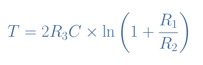

With τ being the time constant equals to the product R3×C. It can be demonstrated that the period T for the output signal can be expressed such as:
eq 1: Output period expression for the astable multivibrator
Therefore, we can see that by increasing either the value of R3 or C, the time constant τ is increased, which increases the charge and discharge time of the capacitor and in turn decreases the frequency of the output signal. Moreover, the period can be modified by changing the values of the feedback resistor (R2) and the resistor at the non-inverting input (R1).

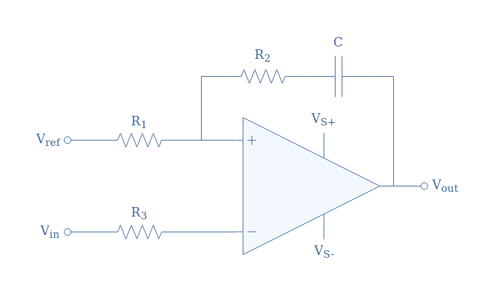

The monostable multivibrator possesses one stable state and one unstable state that can be triggered by an external signal, the period of the unstable state depends mostly on an RC circuit but also on the command.
We present in Figure 6 an op-amp based monostable multivibrator:
fig 6: Monostable multivibrator circuit representation
We can already note that this circuit is an inverting comparator as the input is applied to the inverting pin and compared to the reference provided to the non-inverting pin. If Vin<Vref  (resp. Vin>Vref), we obtain Vout=Vsat (resp. Vout=-Vsat).
When Vin<Vref, the op-amp saturates in positive values, the voltage across the capacitor (which is fully charged) can therefore be expressed by the difference Vsat-Vref. This state is stable as long as the condition Vin<Vref is satisfied.

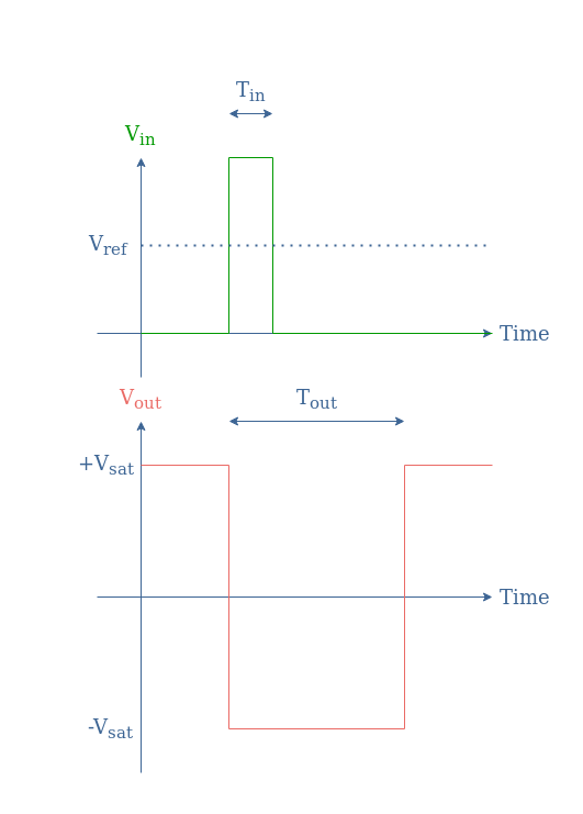

In order to induce a change of state for a certain period Tout, the input signal Vin must increase and be higher than the reference value Vref. This can be achieved with an impulsion of period Tin provided to the inverting input such as shown in Figure 7:
fig 7: Input/output chronogram of the monostable multivibrator
The period Tout for which the system is unstable corresponds to the time constant of the capacitor discharge given by the product R2×C.

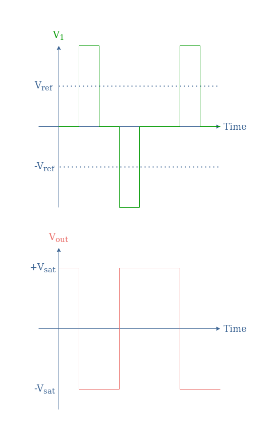

Before detailing the function of this circuit, we present its corresponding chronogram where we show how the transition between states is triggered:
As we can see, the transition from the +Vsat to -Vsat is realized similarly than for the monostable configuration by a positive impulse at the inverting input. The transition back from -Vsat to +Vsat is however not spontaneous as both states are here stable, it requires therefore a negative impulse.
In order for the impulses to effectively trigger the state transition, their absolute value must be higher than a certain reference value (Vref) given by the voltage absolute value at the non-inverting pin βVsat.
To understand the function, we can describe how the circuit behaves depending on the input signal provided:
Before the first input impulse, V1=0 and V+=βVsat, since V+>V1, Vout=+Vsat. When the first positive impulse input is applied, V1>V+ and therefore the output and non-inverting voltage switch both to a low state, respectively Vout=-Vsat and V+=-βVsat. When V1=0 again after the end of the first impulse, the output signal remains at -Vsat because V1>V+. In order to transition back to the initial state, V1 must become lower than V+ which is achieved by a negative impulse of absolute value greater than βVsat.

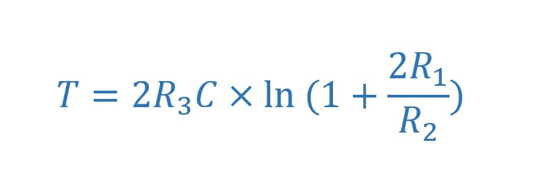

JP D
The formula in eq. 1 is wrong, in the natural logarithm, the correct expression is (1 + 2R1/R2)
mixos
Thanks for noticing, we fixed it.
