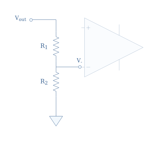

We can see the branches connected to the inverting input acting as a voltage divider circuit:
fig 2: Inverting branches seen as a voltage divider circuit

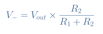

According to the voltage divider formula, we can express the inverting voltage V– as a function of the output voltage and the resistances:

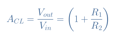

Since V–=Vin, after some simplification, we prove the expression of the gain in closed-loop ACL of an ideal non-inverting configuration:
eq 2: Closed-loop gain of an ideal non-inverting op-amp
We can note that the ideal gain presented in Equation 2 is strictly positive and higher than 1, meaning that the output signal is amplified and in phase with the input signal.

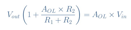

The equations for V+ and V– can be injected in Equation 3. After regrouping the terms “Vout” on one side of the equation and the terms “Vin” on the other, we get:

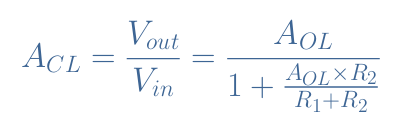

Finally, the closed-loop gain ACL for a real non-inverting configuration is given by Equation 4:
eq 4: Closed-loop gain of a real non-inverting configuration
For a real configuration, the gain not only depends on the resistor values but also on the open-loop gain
It is interesting to note that if we consider the op-amp to be ideal (AOL→+∞), the denominator is simplified to one term: AOLR2/(R1+R2). As a consequence, Equation 4 is simplified back to Equation 2.

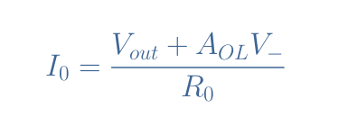

The current I0 across R0 (see Figure 3) can be expressed as a function of the voltage drop across R0 and the same value of the impedance R0:

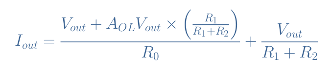

Since V– is described by Equation 1, the output current Iout can be expressed as the sum of I0 and the current flowing in the feedback branch given by Vout/(R1+R2):

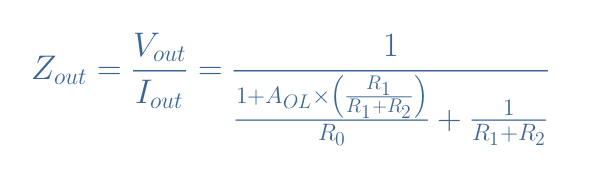

Finally, after rearranging the equation to obtain the ratio Zout=Vout/Iout, we can write the expression of the output impedance for a real non-inverting configuration:
eq 5: Expression of the output impedance for a real non-inverting configuration
We can note that in the case of an ideal op-amp, that is to say when AOL→+∞, we observe indeed Zout→0.
A simplified version for the expression of Zout is given by the following Equation 6:
eq 6: Simplified expression of the output impedance for a real non-inverting configuration
The term β is known as the feedback factor and is given by the ratio R1/(R1+R2). With that simplified version, we can still see that Zout→0 for an ideal op-amp situation.

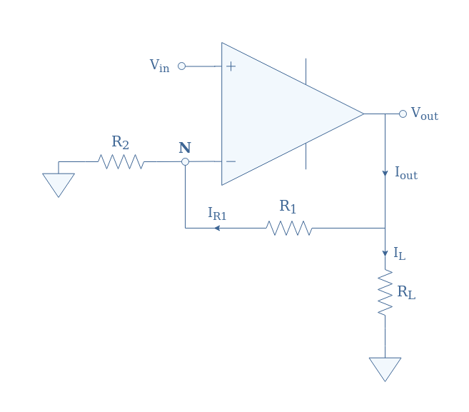

We consider a real non-inverting configuration circuit given in Figure 5:
fig 5: Example of real non-inverting configuration
The resistors, input value, and gain in open-loop are given such as:
  • R1=10 kΩ
  • R2=2 kΩ
  • RL=1 kΩ
  • Vin=1 V
  • AOL=105
First of all, we can compute the value of the closed-loop gain ACL. By using Equation 4 we obtain ACL=5.99 while Equation 2 gives ACL=6. We can remark that both values are very similar since AOL is high. Typical values of AOL for real op-amps range between 2×104 and 2×105, which is high enough to always consider Equation 2 valid.
From this value, we can simply say that the output voltage is given by Vout=ACL×Vin= 6 V.
The currents IR1 (across R1) and IR2 (across R2) are approximately equal if we consider the leaking current in the inverting input to be much lower than the feedback current. Due to the virtual short existing at the node N, VN=Vin, and therefore we have IR1=IR2=Vin/R2=0.5 mA.
Since the current IL through the output load is given by Vout/RL=6 mA, we can determine the output current thanks to Kirchoff’s current law: Iout=IL+IR1=6.5 mA.
Finally, we can also specify the output impedance to be Zout=Vout/Iout=920 Ω.

4 Comments
Kurt
The voltage divider formula near the top is incorrect. It should be, V- = Vout*(R2/(R1+R2)). Otherwise, very well written with clear explanations in step-by-step analysis.
mixos
Thanks for pointing us to this. It’ fixed on the article 🙂
Tom
Still not fixed after 3 months.
mixos
It’s corrected now, could you check?
