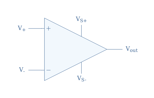

An op-amp is usually represented as a triangle with 5 pins from which 4 are inputs and one is the output.
fig 1: Representation and pin configuration of an op-amp
The output is labeled Vout and it is the pin where the output voltage is collected. V+ and V– are respectively the non-inverting and inverting inputs. VS+ and VS- are respectively the positive power supply and negative power supply rails.
We can note that in most of the op-amps representations, the power supply voltages and pins are not represented in order to simplify the drawing. Most of the time, the power configuration is just assumed or not relevant to perform calculations on a specific op-amp.

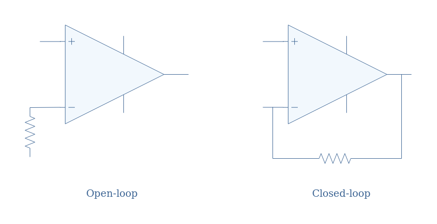

The term “open-loop” refers to the fact that no feedback is applied from the output to the inverting input of the op-amp. We will come back to that notion later on in the tutorial, however, in order to get an idea now of this concept, we show in Figure 3 the distinction made between open-loop and closed-loop op-amps:

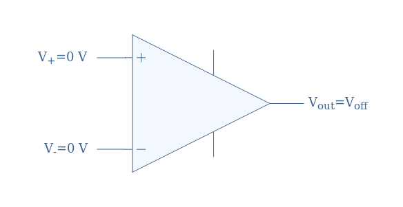

The offset voltage Voff can be read at the output terminal when no input is applied to the amplifier. For example, if an op-amp has an offset voltage of 1 V, it means that the output voltage will constantly be shifted of +1 V, even when no input signal is applied.

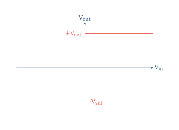

One very important property is that in an open-loop configuration, the output of an ideal op-amp can only take two values called the saturation voltages (Vsat). If the differential input Vin is positive (reciprocally negative), the output is +Vsat (reciprocally -Vsat).
fig 7: Vout=f(Vin) characteristic of an ideal op-amp in open-loop
The value of |Vsat| is slightly lower than the absolute value of the supply VS.

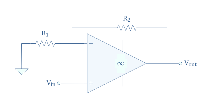

If instead the feedback is applied to the inverting input (-) of the op-amp, the function of the amplifier is completely different.
fig 9: Ideal op-amp in linear mode (negative feedback)
In this configuration, any increase of the output voltage tends to decrease the differential input and therefore, also tends to maintain a differential input close to zero.
The relation between the input and output voltages is given by Equation 2:
eq 2: Transfer function of the op-amp presented in Figure 7

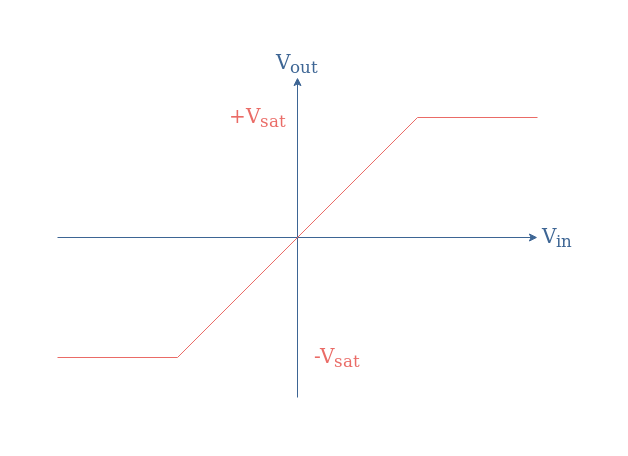

In a closed-loop configuration with negative feedback, the characteristic Vout=f(Vin) is therefore linear according to Equation 2 up until -Vsat and +Vsat where a plateau emerges.
