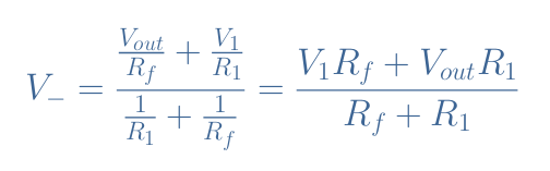

The voltage V– can be written thanks to Millman’s theorem which stipulates that the potential at a node can be written as the sum of the currents entering the node and divided by the sum of the admittances in each branch:
Since we suppose V+=V–, both previous equations are also equal. After rearranging this equality, we finally obtain the output expression for a differential amplifier in the general case, which is a superposition of both inputs V1 and V2:

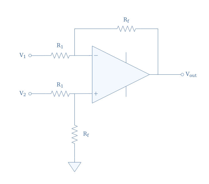

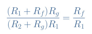

The configuration R1≠R2≠Rf≠Rg is however never used in real circuits. What we should aim for when designing a differential amplifier is to get an output of the form Vout=A(V2-V1), with A being a common factor.
In the following paragraphs, we show under which condition (that we call differential condition) this common factor can be written.
In order to get a common factor for V1 and V2, the following equality must be satisfied:
After some basic simplification steps, the differential condition can finally be written Rf/R1=Rg/R2. In this case, we obtain indeed Vout=A(V2-V1) with A=Rf/R1.
We can even simplify the circuit by choosing R1=R2 and Rf=Rg (which still satisfies the differential condition and with again A=Rf/R1):
fig 2: Differential amplifier operating in differential mode

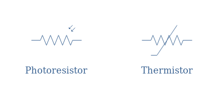

Dependent resistor
In the following, we present the basics of resistors which resistance values depend on the light intensity (photoresistor) or on the temperature (thermistor).
fig 3: Photoresistor and thermistor symbols

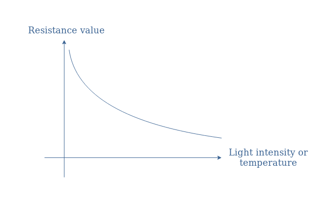

A good modelization for both photoresistor and thermistor resistance values is to consider an exponential decrease with an increase of the light intensity or temperature:
fig 4: Transfer function of dependent resistors

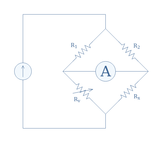

Wheatstone bridge
A Wheatstone bridge is a measuring circuit composed of 4 resistors interconnected in a loop configuration such as shown in Figure 5. One of the resistors has an unknown value (Rx), one is a variable resistor (Rv), and two have known and fixed values (R1 and R2).
fig 5: Circuit representation of a Wheatstone bridge
We won’t explain here the details about the measuring procedure of a Wheatstone bridge but we will assume that when no current is detected by the galvanometer (or amp meter) across the nodes R1-Rv and R2-Rx after adjusting the value of Rv, the resistance Rx is given by Equation 1.
This condition is also known as the balancing condition of the Wheatstone bridge.
eq 1: Unknown resistance value of a Wheatstone bridge

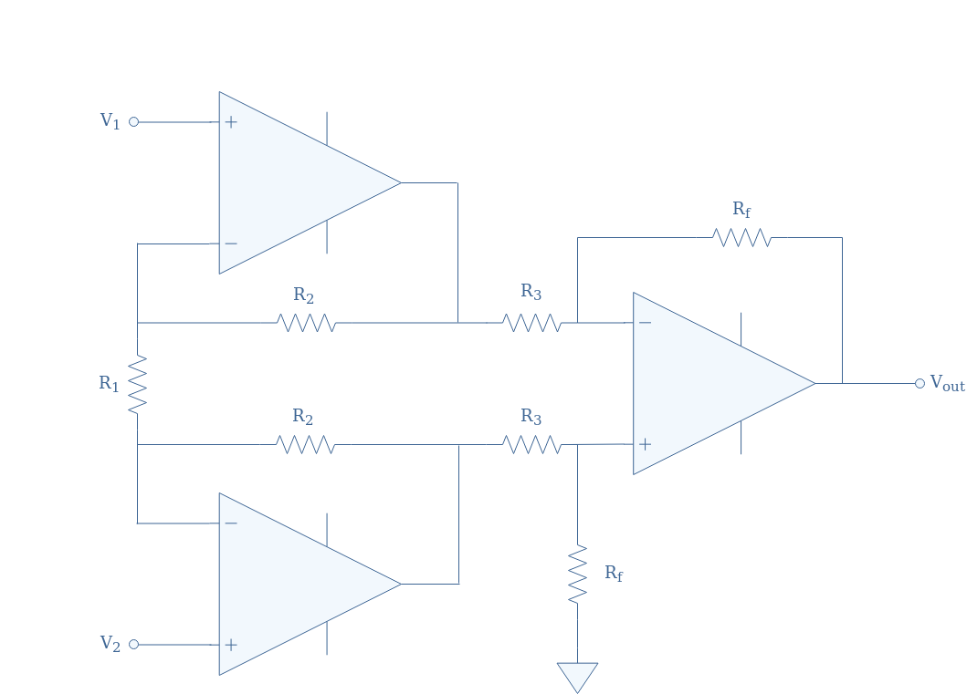

One of the limitations of differentials amplifiers when it comes to process sensors outputs is its relatively low input impedance. Indeed, the input impedance of the general configuration presented in Figure 1 is equal to R1+R2, which is much lower than the input impedance of a common non-inverting op-amp.
In practice, for this reason, differential amplifiers are never used alone for processing sensor outputs as their low input impedance can bias what the source (sensor in our case) provides (see the tutorial op-amp building blocks for more information).
The solution to increasing the input impedance is to connect voltage followers before the inverting and non-inverting inputs of the differential amplifier. This configuration, known as an instrumentation amplifier, is presented in Figure 7 below:
fig 7: Instrumentation amplifier circuit representation
The voltage drop across the resistor R1, which is the input of the differential amplifier, is equal to V2-V1, except that this time, the sources of the signals V1 and V2 sees a very high input impedance thanks to both buffers.
