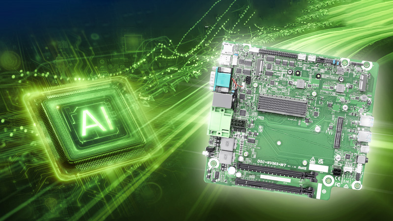

ASRock Industrial has recently introduced the DSC-NV003-WT, a Jetson AGX Orin developer kit designed for Edge AI workloads. With up to 275 TOPS of AI performance and a wide operating temperature range, it’s suitable for robotics, drones, industrial automation, smart cities, and vision-based applications.
The kit supports multiple NVIDIA Jetson AGX Orin SKUs (Industrial/64GB/32GB) and supports 12 PoE ports for vision systems, a 120-pin MIPI connector for up to four 4-lane MIPI or GMSLII cameras, and dual PCIe Gen4 x8 slots for expansion. Storage options include onboard 64GB eMMC, microSD, and NVMe SSD via M.2 Key-M. Connectivity options include a GbE and a 2.5GbE LAN, optional 5G/4G LTE, and Wi-Fi. I/O options include 4x USB 3.2, USB-C (device mode), dual RS-232/422/485, and audio headers. The carrier board also exposes GPIO, I2C, SPI, CAN, and PWM through a 40-pin header. The kit supports a wide operating voltage range of 12–48V DC, making it suitable for various applications.

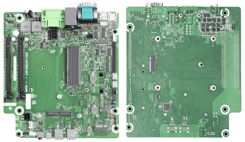

DSC-NV003-WT kit Top and Bottom

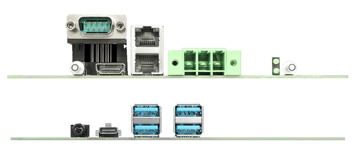

Jetson AGX Orin devkit ports
