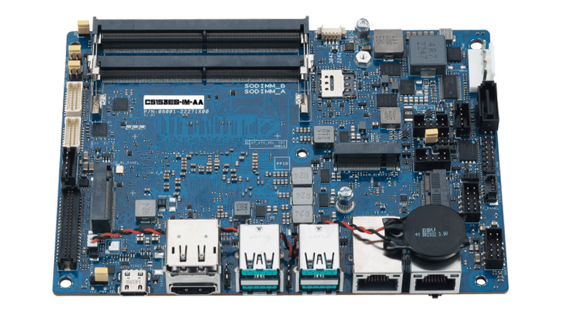

ASUS Intel Core Ultra 5/7 3.5-inch SBC The ASUS C5153ES-IM-AA and C7156ES-IM-AA expand the company’s low-power 3.5-inch SBC lineup, pairing Intel Core Ultra 5/7 processors with wide-voltage input, rich expansion, and multi-display support for embedded and industrial deployments. ASUS IoT has unveiled the C5153ES-IM-AA and C7156ES-IM-AA, two low-power 3.5-inch SBCs built around the Intel Core Ultra processors, designed for industrial and embedded computing where low power and high performance are essential.
Both boards support up to 64GB DDR5 memory, triple M.2 slots for NVMe, Wi-Fi, and 5G expansion, dual Ethernet (1GbE + 2.5GbE), and multiple display outputs including HDMI 2.1, DP 1.4, USB-C, and LVDS/eDP. They also integrate Realtek HD audio, TPM security, wide 9–36V DC input, and BIOS watchdog timer, making them suitable for edge AI, industrial control, and multi-display embedded systems.

ASUS C5153ES-IM-AA and C7156ES-IM-AA Specifications:
  • SoC
    • Intel Core Ultra 7 265U, 12 cores, 2.1 GHz base / up to 5.3 GHz turbo, 15W TDP (C7156ES-IM-AA)
    • Intel Core Ultra 5 235U, 12 cores, 2.0 GHz base / up to 4.9 GHz turbo, 15W TDP (C5153ES-IM-AA)
  • Memory
    • 2x SO-DIMM DDR5-6400 sockets, up to 64 GB (both models)
  • Storage
    • M.2 M-key (2280, PCIe x4) – NVMe SSD
    • 1× SATA Gen3 (6 Gbps) with power connector
  • Display (Intel Xe LPG Graphics)
    • HDMI 2.1 up to 4096×2160 @ 60 Hz
    • DP 1.4 up to 5120×3200 @ 60 Hz
    • USB-C with DP 1.4 Alt-mode
    • LVDS up to 1920×1080 @ 60 Hz (shared with eDP 1.4b, request-based) with LVDS power jumper
    • Supports up to 4 simultaneous displays: HDMI + DP + USB-C + LVDS/eDP
  • Networking
    • Dual LAN – Intel i219LM (1 GbE) and Intel® I226IT (2.5 GbE)
    • M.2 E-key (2230) – Wi-Fi 6E / BT 5.2 (CNVi supported)
    • M.2 B-key (3042/3052) – LTE/5G module with onboard SIM slot
  • Audio
    • Realtek ALC897 HD Audio Codec
    • Front panel audio header + internal stereo speaker connector (with AMP IC)
  • USB
    • 4× USB 3.2 Gen2 (10 Gbps)
    • 1× USB2.0 header (2 ports)
    • 1× USB-C (DP 1.4 Alt Mode)
  • Serial
    • 2× serial headers (supporting 4× RS-232/422/485) with COM voltage selection
  • Debug
    • 1x Debug header
  • Secutiy
    • TPM header (SPI)
  • Expansion
  • Misc
    • Power/HDD LEDs
    • GPIO (8-bit), SMBus, I²C headers
    • Chassis fan, intrusion, system panel headers
    • BIOS watchdog
  • Power
    • 9–36 V DC input with AT/ATX jumper
  •  Dimesions
    • 146 mm × 105 mm (3.5-Inch SBC)
  • Operating temp
    • -20 °C to 60 °C, storage: -40 °C to 85 °C
  • Relative humidity
    • 10–95% (non-condensing)
  • Certifications
    • CE, FCC, BSMI, VCCI, ISED, EN62368
The primary difference between the two SBCs lies in their processor specifications, while most other features remain the same.
Both the  SBCs support Microsoft Windows 11 IoT Enterprise and Windows 10 IoT Enterprise, as well as Ubuntu Linux distributions. The platforms include BIOS-level watchdog functionality and an SPI TPM header for secure boot and encryption features, which ensures compatibility with enterprise-grade security and management requirements.
ASUS has not yet disclosed the pricing for the C7156ES-IM-AA and C5153ES-IM-AA Low-Power 3.5-Inch SBCs, but more information is available on the respective product pages.
