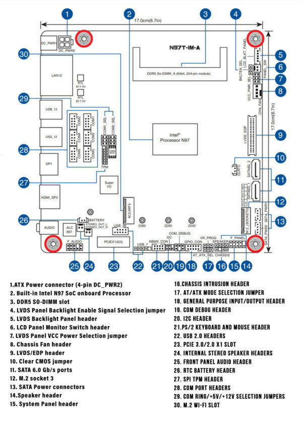

Asus N97T-IM-A Mini ITX Motherboard Block Diagram
