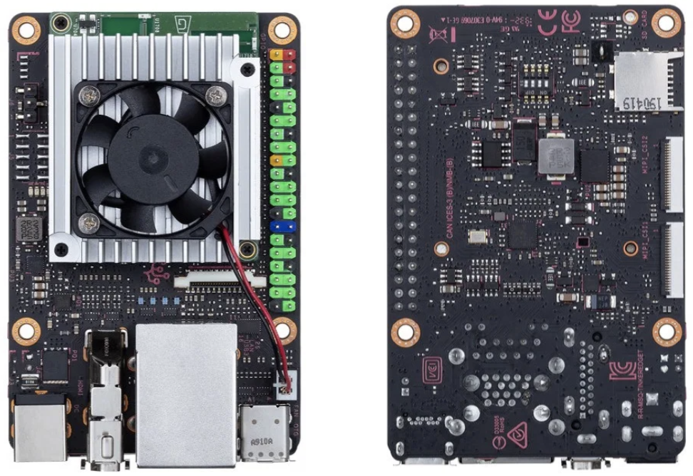

ASUS unveils coral-based Tinker Edge T
Tinker Edge T, is an SBC developed by ASUS that comes equipped with an i.MX8M and an Edge TPU, running the Debian-based Mendel OS Linux on a coral SOM module with a cross-platform OS flash tool that enables easy OS image flashing to SD cards and USB drives, enabling users to get their system up and running quickly. It seems to be an open-spec board, much like Asus’ earlier released Rockchip RK3288-based Tinker Board S, and it is probably planned to serve as Asus’ equivalent of Google’s Coral Dev Board.
It seems to be an open-spec board, much like Asus’ earlier released Rockchip RK3288-based Tinker Board S, and it is probably planned to serve as Asus’ equivalent of Google’s Coral Dev Board. The board offers two faster-10Gbps USB 3.2 Gen1 ports, a USB 3.2 Type-C OTG port with both power and peripheral support while the Coral Dev Board has USB 3.0 host, USB 3.0 Type-C power, and micro-USB serial console ports. The Tinker Edge T lacks the Coral Dev Board’s audio features: 3.5mm audio jack, two digital PDM mics, and stereo speaker header, but it comes with three PWM, a set of I2S pins on the Raspberry Pi-like 40-pin expansion header, and supplies dual 4-lane, MIPI-CSI2 interfaces.
The Asus Tinker Edge T is also designed such that it delivers 45 watts of power with a DC head power supply, enabling stable system operation, and full I/O performance, even with multiple connected devices. This is a significant feature as the power design of most SBC’s including the Coral Dev Board is usually 5v, 3A.
