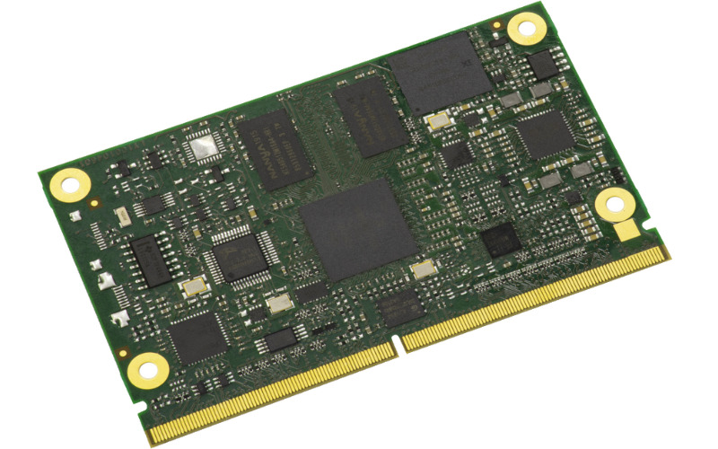

Most of you have been on the Hackster.io website to check for interesting embedded IoT projects. Hackster’s parent company, a New York-based electronics components distributor, Avnet, has launched the MSC SM2S-IMX8ULP module, which is compliant with the Smart Mobility Architecture (SMARC) 2.1.2 standard form factor. This allows easy integration of the new module with the SMARC baseboards (also referred to as carrier boards). The SMARC-compliant module pairs up the NXP low-power, high-performance processor and LPDDR4 memory integrated with up to 256GB of eMMC flash storage.
At the heart of the MSC SM2S-IMX8ULP module is the NXP i.MX 8M Arm processor architecture features two ARM Cortex-A35 processor cores clocked up to a frequency of 1GHz, and an Arm Cortex-M33 core. While Cortex-A35 is the smallest and power-efficient smart home processor supporting multiple software applications, the Cortex-M33 is efficient for IoT and embedded applications that require digital signal control and security. Additionally, a 3D/2D Graphics Processing Unit (GPUs), a Tensilica Hifi 4 DSP, and Fusion DSP for low-power audio/voice and edge AI/ML processing are also included in the i.MX 8ULP processor.
