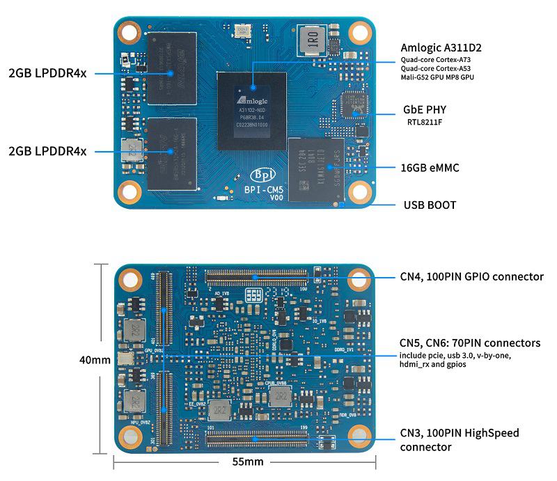

Features:
  • Amlogic A311D2,quad-core Cortex-A73 and quad-core Cortex-A53 SOC
  • Mali-G52 GPU MP8 GPU
  • 4GB LPDDR4/LPDDR4x (Max 8G)
  • 16G eMMC flash (Max 128G)
  • Designed with Board to Board connectors for enhanced stability same as RasPi CM4
  • One on-board Gigabit Ethernet
  • One PCIe2.0 interface expansion, can flexibly add related modules
  • One USB3.0 port up to 5Gbps
  • One USB2.0 high-speed USB/IO witch support USB OTG
  • Three HDMI2.1 receiver ports
  • one HDMI2.1 transmitter port with CEC
  • two 8-lane V-by-One output can support up to 4Kx2K resolution(Multiplexing with MIPI-DSI/eDP/LVDS)
  • two 4-lane MIPI-CSI camera interface with 16Mp ISP
