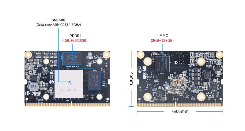

BPI-SM9 SoM Hardware Overview
The Banana Pi BPI-SM9 compute module is currently listed at USD $152.00 on the official Banana Pi store, while third-party marketplaces such as AliExpress store price the 8GB LPDDR4 + 32GB eMMC version at around US $52.50 (or US $42 after discounts). Pricing can vary significantly between platforms, so buyers should compare listings across the official shop and AliExpress, and other stores to find the best available offer.
More information about the product is available on the product’s page.
