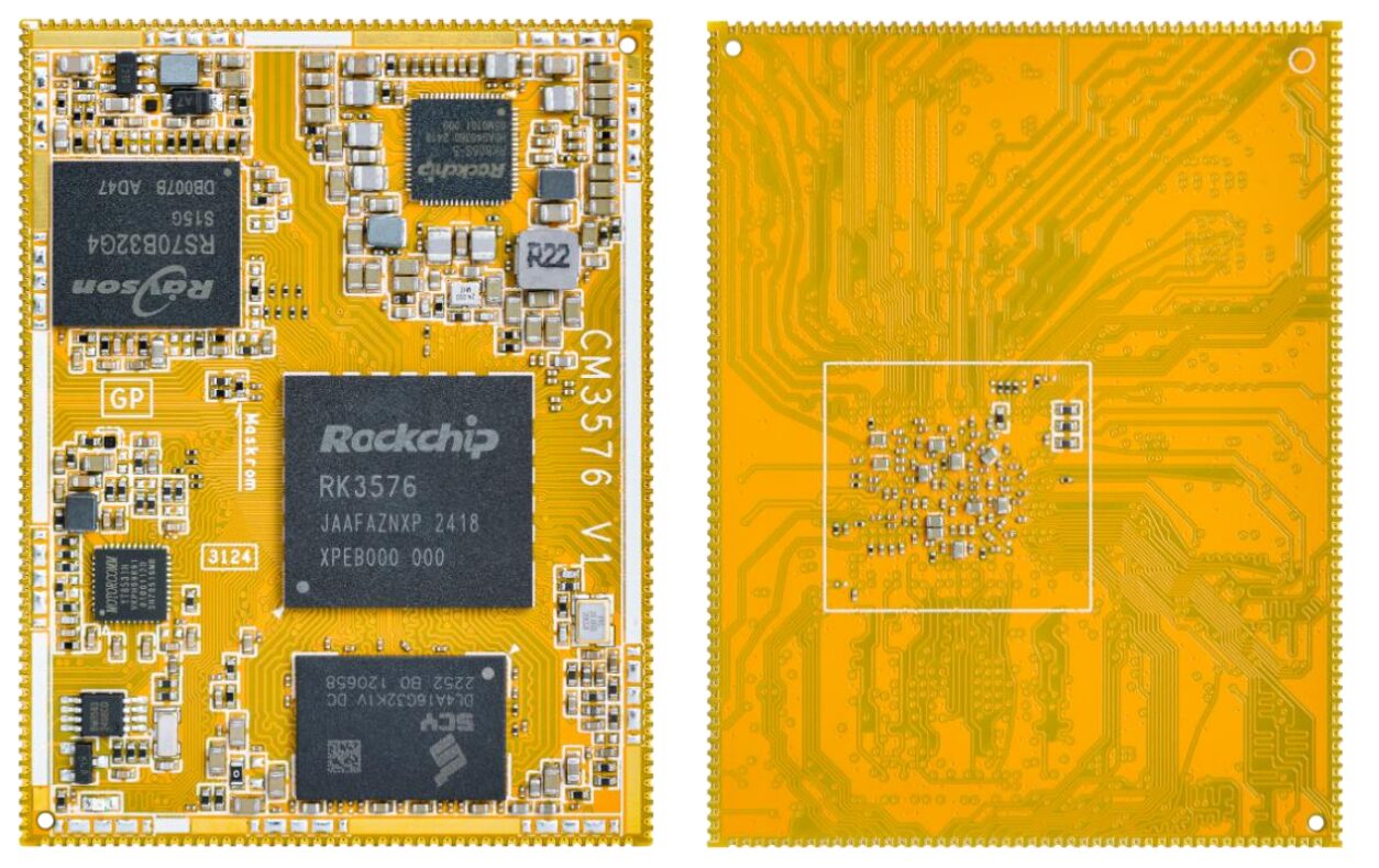

Boardcom has recently introduced CM3576 SoM and EM3576 its associated development board, together with a development kit. The unique thing about this kit is that it supports 12 analog camera inputs along with various interfaces like HDMI, GbE Ethernet, USB, Serial GPIO, and much more.

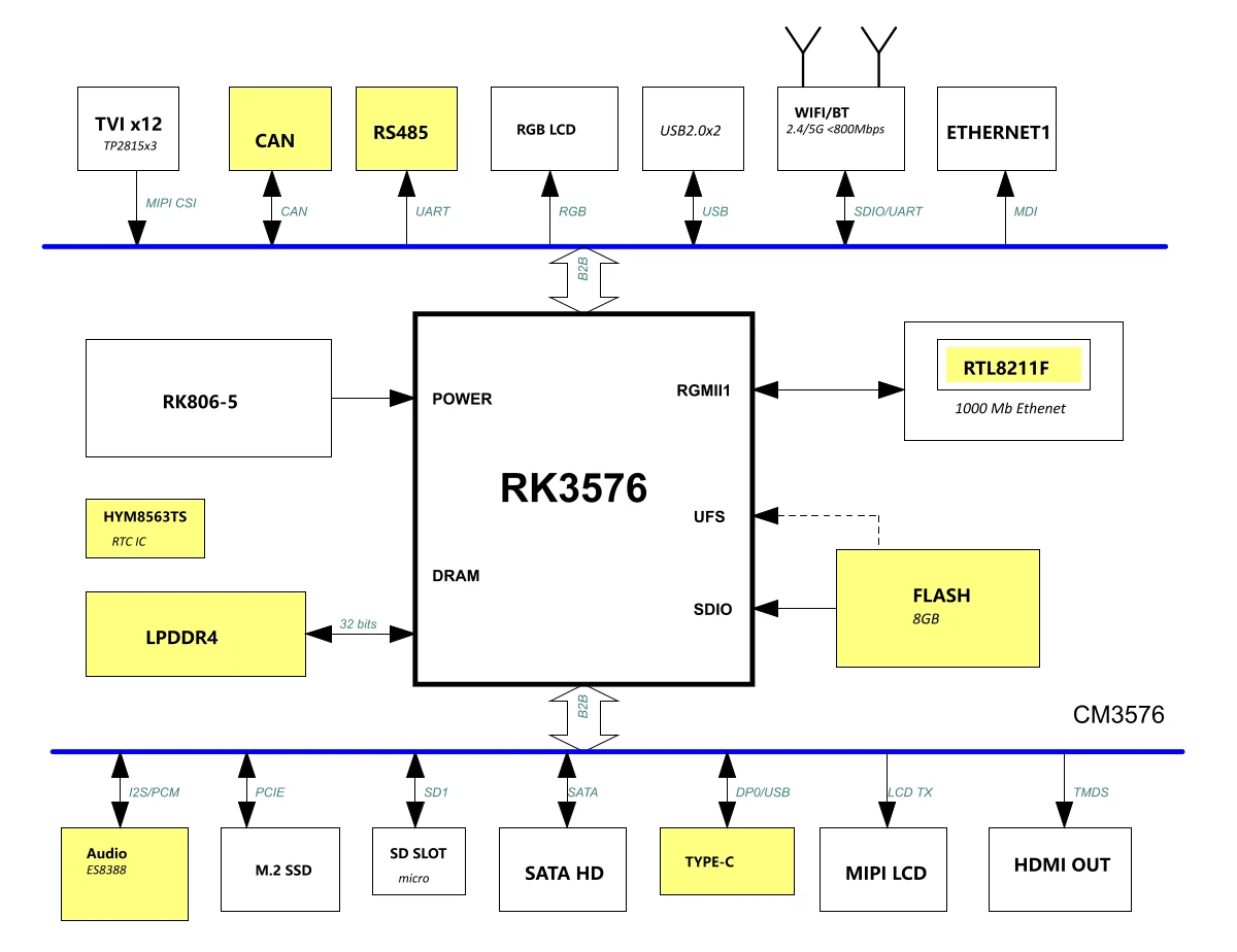

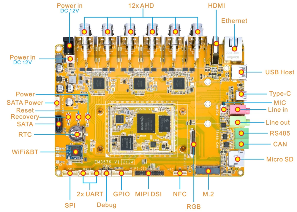

The EM3576 development board holds the CM3576 SoM and, offers a platform for initial software development and evaluation. It provides access to various interfaces, including twelve analog camera inputs, HDMI, MIPI DSI, 3.5mm Audio Jace RGB Connector, Gigabit Ethernet, Dual-band WiFi 5, NFC, and much more.

The company mentions that the CM3576 system-on-module and EM3576 development can be utilized for industrial automation, robotics, video surveillance, automotive safety systems, and smart home solutions.
