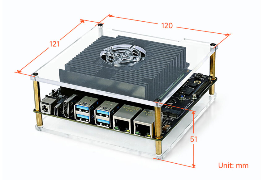

The D-Robotics RDK S100 is a high-performance robot development kit featuring 80 TOPS of AI computing power via its Nash BPU, designed for embodied robotics applications. With its unique dual-brain architecture combining CPU, BPU, and MCU cores, it enables real-time AI inference and motion control on a single platform.
Designed for robotics and AI-driven systems, the kit integrates a 6-core Cortex-A78AE CPU, 4-core Cortex-R52+ MCU, and Mali-G78AE GPU, with 12GB LPDDR5 RAM and 64GB eMMC storage. Connectivity options include dual GbE LAN, four USB 3.0 ports, and HDMI output. There is an option for M.2 Key-M and Key-E slots for storage and wireless expansion, finally, a 40-pin GPIO header vives access to all the IOs. It supports up to 2K@60FPS HDMI displays, onboard JTAG and debug ports, and includes a development suite with 200+ open-source AI algorithms.
D-Robotics RDK S100 Specifications:
  • SoC: RDK S100 Intelligent Computing Core
    • 1x Nash BPU (80 TOPS, INT8)
    • 6x Arm Cortex-A78AE @ 1.5GHz
    • 4x Arm Cortex-R52+ @ 1.2GHz
    • 1x Arm Mali-G78AE GPU @ 100 GFLOPS
  • Memory: 12GB LPDDR5 (96-bit bus)
  • Storage: 64GB eMMC, M.2 Key M (PCIe 3.0 x1) SSD slot
  • Display: HDMI 1.4, up to 2K @ 60Hz
  • Networking: 2x Gigabit Ethernet (RJ45)
  • Wireless Expansion: M.2 Key E (PCIe 3.0 x1, UART) for Wi-Fi/Bluetooth
  • USB:1x USB 2.0 Type-C (flashing/debug), 4x USB 3.0 Type-A
  • Expansion
    • 40-pin Main GPIO header
    • 16-pin MCU GPIO header
    • JTAG, MCU expansion, camera headers (100-pin)
    • M.2 Key M (PCIe 3.0 x1) SSD slot
    • M.2 Key E For
  • Power Supply: 12V–20V DC (70W/150W recommended)
  • Dimensions: 120 x 121 x 51 mm (with case)
The RDK S100 includes a full development suite with over 200 open-source algorithms optimized for AI perception and robotic control. It supports heterogeneous scheduling between CPU, BPU, and MCU, enabling real-time task offloading and dynamic inference. The onboard MCU supports deterministic control tasks and high-frequency communication, while the CPU handles mid-level logic and the BPU accelerates neural network execution. More information can be found on RDK S100’s wiki page. But there is no information available on the wiki.
