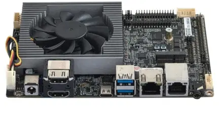

DFI AL551 Single Board Computer
The AL551 supports all of Intel’s Apollo Lake SoCs. Most notably the Intel Atom® Processor E3900 Series is supported. The 146 x 102mm SBC is equipped with up to 8GB DDR3L and offers a SATA III interface with power, with the option for a second SATA device if the available M.2 slot is populated. There’s also a mini-PCIe slot and an optional “extension I/O” connector. The AL551 also comes with one or two GbE ports.
Triple displays are supported via a VGA port, a 4K-ready DisplayPort++, and dual-channel LVDS with LCD panel and inverter support. The SBC is provided with 2x USB 3.0, 2x USB 2.0, and two more USB 2.0 headers, and if you’re planning to run Ubuntu, you can optionally order a USB Type-C port. There’s also a pair of 2x RS232/422/485 headers, audio I/O, DIO, SMBus, a watchdog, and optional TPM.
