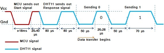

DHT11 is a common humidity & temperature sensor. This sensor has a single wire serial interface with special timing diagram for the single wire interface.
dht11_timing_diagram
When the MCU sends a start signal, DHT11 sends a response signal followed by the humidity reading and then the temperature reading.
