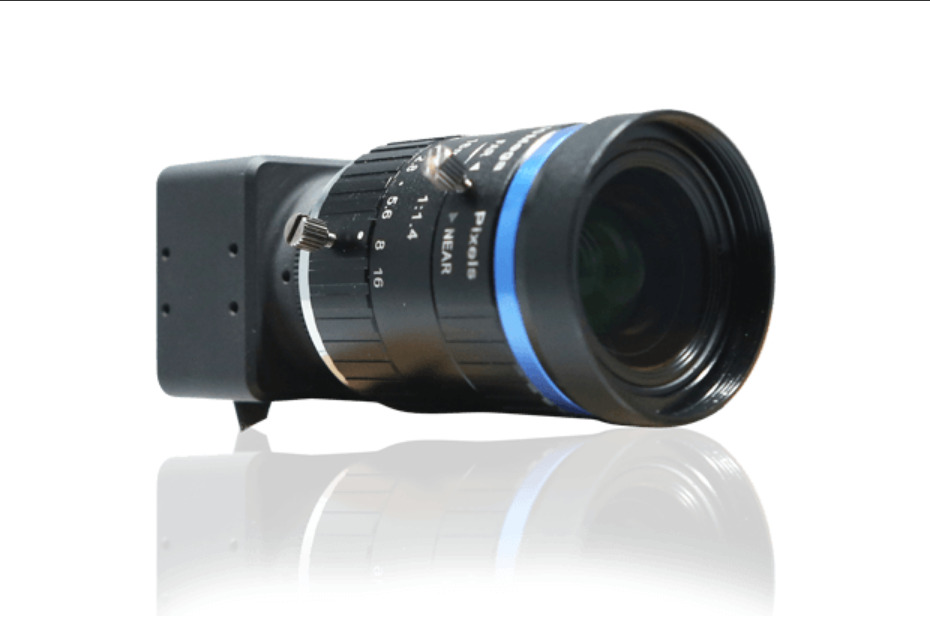

NVIDIA Jetson AGX Orin | Sony STARVIS IMX485 | 1/1.2” sensor | Large pixel size | 4K resolution | Multi-camera solution e-con Systems™, a leading embedded OEM camera company, and an NVIDIA Elite Partner, today launched the e-CAM82_CUOAGX – a 4K ultra-low-light camera powered by the NVIDIA® Jetson AGX Orin™ system-on-a-module and based on the Sony STARVIS IMX485 sensor. The product will be officially launched at Embedded World 2022, to be held at the Exhibition Centre in Nuremberg, Germany, from June 21st to 23rd.

This large sensor camera (1/1.2”) can be readily integrated with NVIDIA Jetson AGX Orin and is designed to address the rising processing needs of AI-based embedded vision applications such as autonomous mobile robots and agricultural vehicles. This large sensor size will also enable
e-CAM82_CUOAGX to capture high-resolution images with more detail and clarity.
In addition, this low-light camera houses the Sony STARVIS IMX485 sensor with a large pixel size of 2.9µm (H) x 2.9µm (V), which is double the size of most 4K sensors available in the market today. This, in turn, will ensure high sensitivity even in absolute darkness.
e-CAM82_CUOAGX is a multi-camera solution that can connect up to 6 cameras to have an extended field of view for building 360-degree surround-view systems.  Further, e-con Systems will support any customization required on NVIDIA Isaac ROS to reduce the camera integration efforts for robotic vision systems.
