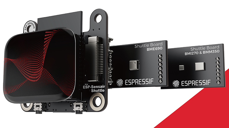

In order to advance the deep integration of multimodal sensing and intelligent interaction technologies, Espressif and Bosch Sensortec jointly introduced the ESP-SensairShuttle development board for motion sensing and large language model human-computer interaction scenarios. The ESP32-C5 wireless SoC family from Espressif serves as the foundation for the core board, making it appropriate for common application scenarios like smart offices, smart homes, sports health, and AI toys.
The ESP-SensairShuttle mainboard, which uses an ESP32-C5-WROOM-1-N16R8 module with 16 MB SPI flash and 8 MB PSRAM, is at the center. The setup consists of a low-power RISC-V core (40 MHz) designed for power-sensitive tasks in addition to the ESP32-C5’s single-core 32-bit RISC-V application CPU (up to 240 MHz). Bluetooth 5 LE (including Mesh), dual-band 2.4 GHz and 5 GHz Wi-Fi 6 (with backwards compatibility to older Wi-Fi modes), and an 802.15.4 radio for Zigbee/Thread-class stacks are all supported. Regarding interaction, the kit comes with a tiny integrated display: a 1.83-inch touchscreen with 240 x 284 pixels that is powered by a ST7789P3 controller via 4-wire SPI. By swapping out various Shuttle sensor daughterboards (Espressif officially supports BME690 and BMI270 & BMM350 daughterboards), users can flexibly achieve multi-dimensional sensing such as air quality, gesture actions, attitude direction, and magnetic field information. This is appropriate for teaching demonstrations, algorithm verification, and multi-scenario prototype development. Based on Bosch’s BME690, the first is called ShuttleBoard-BME690. Temperature, humidity, pressure, and gas sensing are all provided by this multifunctional environmental component. The BMI270 IMU and BMM350 magnetometer are combined in the second model, ShuttleBoard-BMI270 & BMM350.

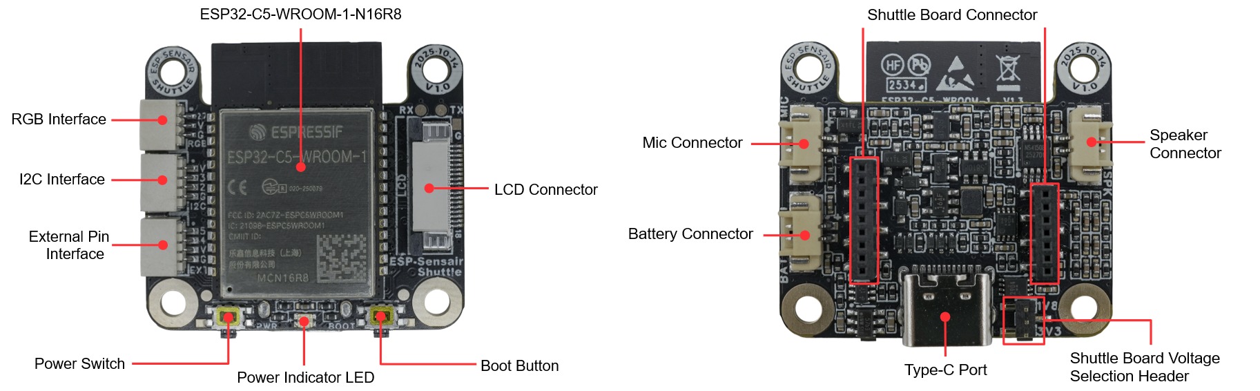

ESP-SensairShuttle development board - Mainboard PCB Front and Back Description
SensairShuttle-Mainboard PCB Front and Back Description

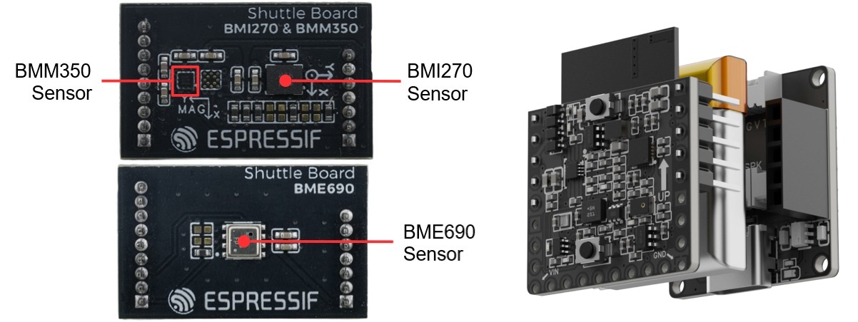

BME690 and BMI270+BMM350 Shuttle Boards

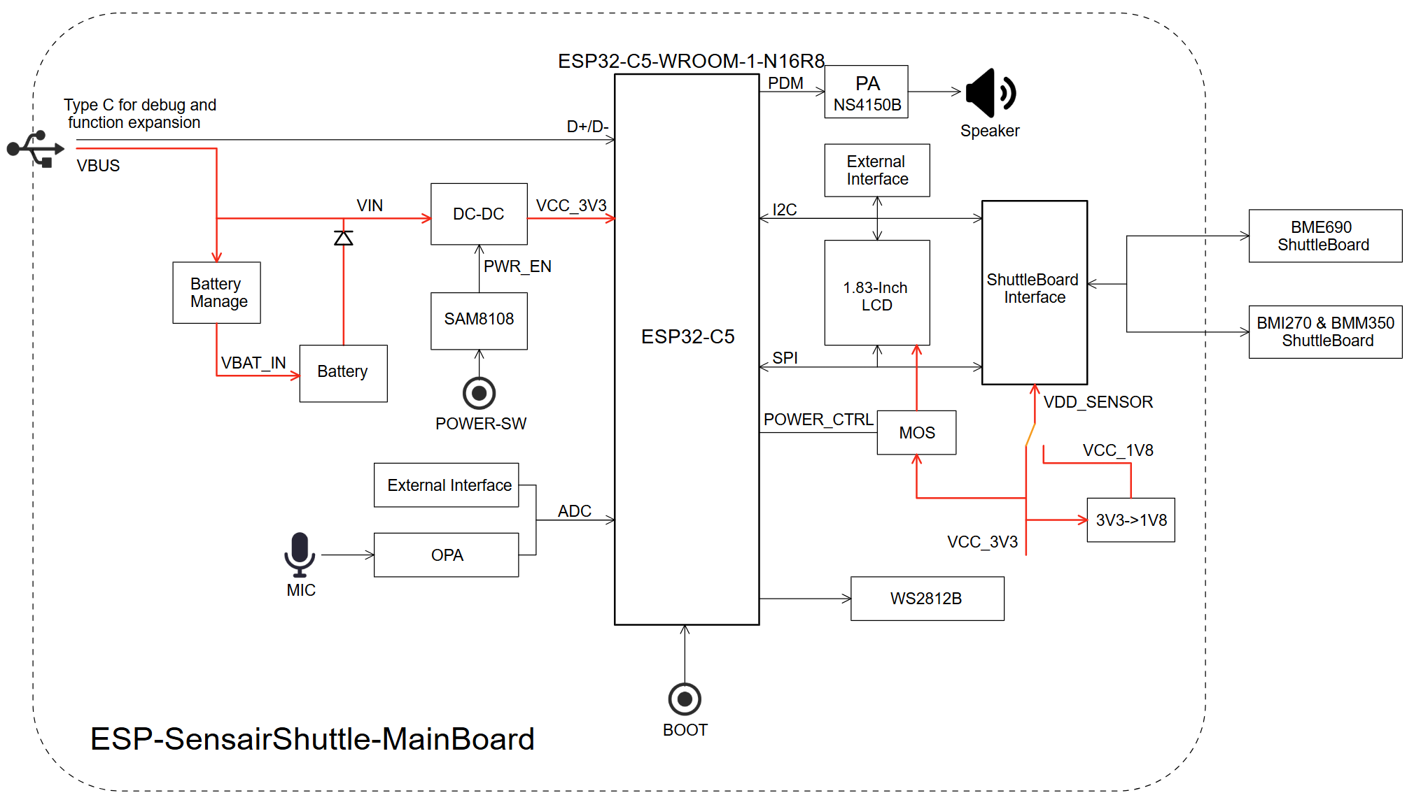

Block Diagram
ESP-SensairShuttle Function Block Diagram
