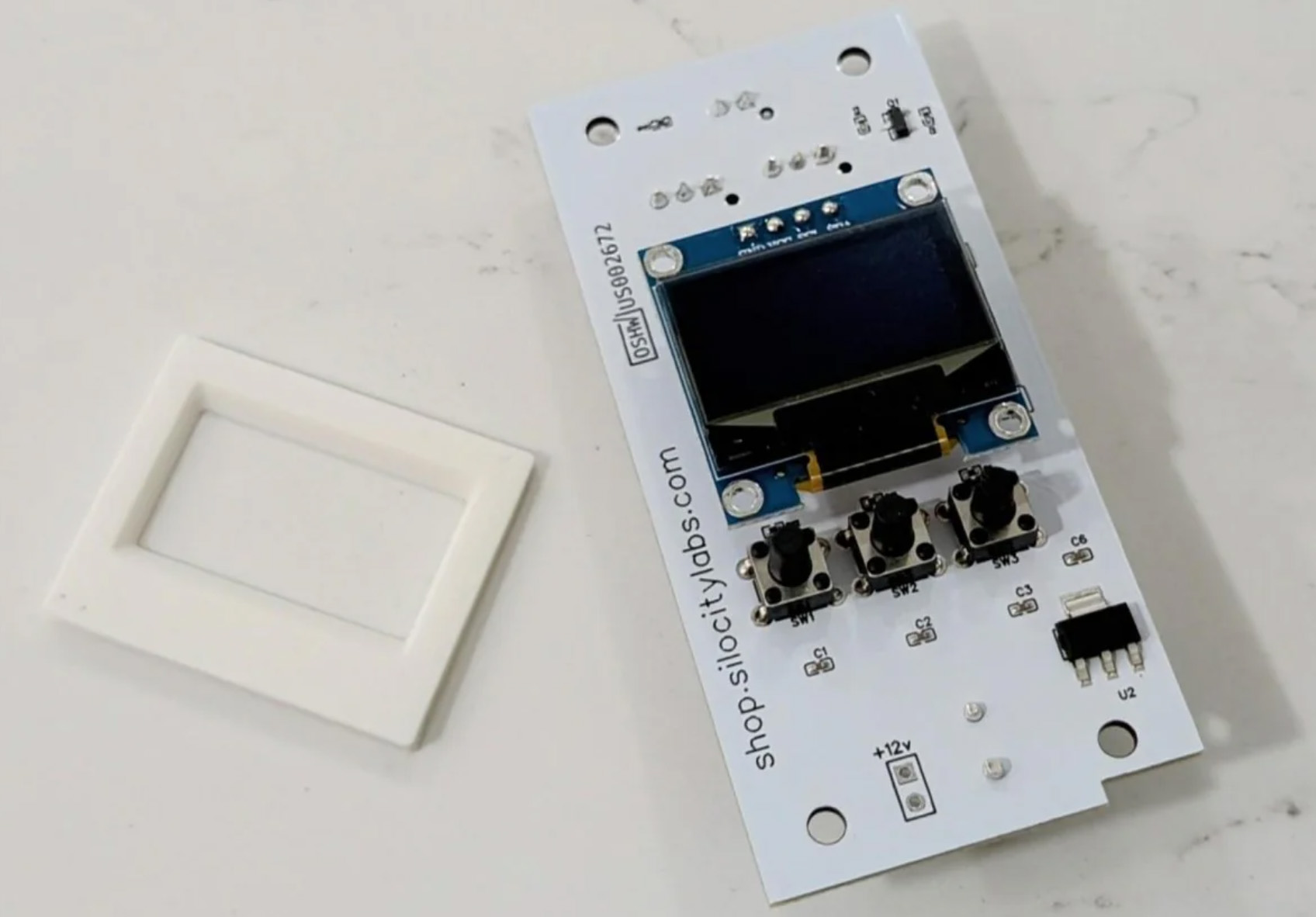

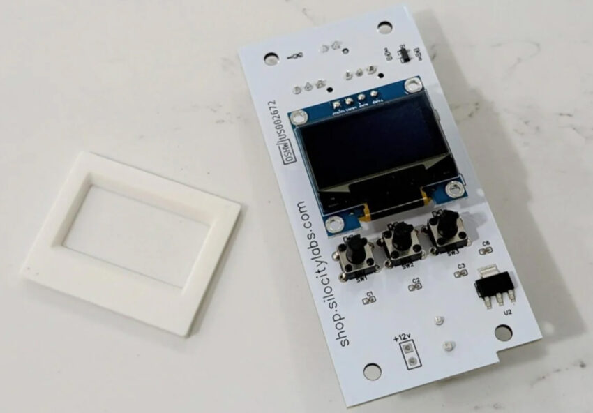

The AC Infinity Airtap T4/T6 is a drop-in replacement board for the AC Infinity Airtap Fans. It works with both 3-button and 4-button models and adds Wi-Fi and smart home support using ESPHome, so you can control your fan from your phone or Home Assistant.

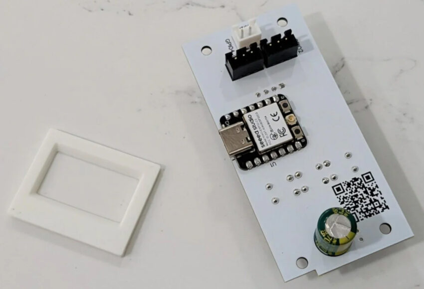

The board is built around the Seeed Studio Xaio ESP32-C3 module and includes a small OLED screen, a temperature sensor, and supports one or two PWM fan outputs, depending on the version. It’s built around the ESP32-C3 chip for strong Wi-Fi connectivity and easy firmware updates.
The module fits neatly inside the fan’s original case and supports models like AC-RBF4, RBF6, and more. The 4-button version is plug-and-play, while the 3-button version may need basic soldering for power. It’s certified open-source hardware and designed to make your fan smarter with automation and remote monitoring.

The ESP32 module is preloaded with ESPHome-compatible firmware, and YAML configuration files are provided for both 3-button and 4-button models. It can be flashed via USB using standard ESPHome tools and supports OTA updates. The firmware includes support for the OLED display, PWM fan control, button inputs, and temperature sensing. It integrates natively with Home Assistant through ESPHome’s API, making setup and automation straightforward. More information can be found on the company’s GitHub repository.
