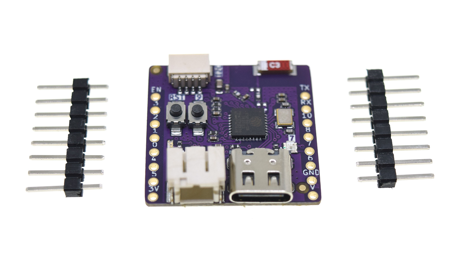

Espressif Systems ESP32-C3
ESP32-C3 is a single-core Wi-Fi and Bluetooth® 5 Low Energy (BLE5) MCU, based on the open-source RISC-V architecture ESP32-C3 is a single-core Wi-Fi and Bluetooth® 5 Low Energy (BLE5) MCU, based on the open-source RISC-V architecture. It strikes the right balance of power, I/O capabilities, and security, thus offering the optimal cost-effective solution for connected devices.
The availability of Wi-Fi and Bluetooth 5 (LE) connectivity not only makes the device’s configuration easy but also facilitates a variety of use-cases based on dual connectivity.
Key features
  • State-of-the-art power and RF performance
  • Unparalleled security for your connected devices
  • Cost-effective
  • Wi-Fi and Bluetooth 5 (LE) connectivity
Additional features
  • CPU and memory:
    • 32-bit RISC-V single-core processor, up to 160 MHz
    • 384 KB ROM
    • 400 KB SRAM (16 KB for cache)
    • 8 KB SRAM in RTC
  • Interfaces:
    • 22 programmable GPIOs, SPI, UART, I2C, I2S, LED PWM, TWAI, full-speed USB Serial/JTAG controller
  • Wi-Fi:
    • IEEE 802.11 b/g/n-compliant
    • Supports 20 MHz, 40 MHz bandwidth in 2.4 GHz band
    • 1T1R mode with data rate up to 150 Mbps
  • Bluetooth:
    • Bluetooth LE: Bluetooth 5, Bluetooth mesh
    • Speed: 125 Kbps, 500 Kbps, 1 Mbps, 2 Mbps
    • Advertising extensions
  • Security:
    • RSA-3072-based secure boot
    • AES-128-XTS-based flash encryption
    • Digital signature peripheral and the HMAC peripheral
    • Hardware acceleration support for cryptographic algorithms
