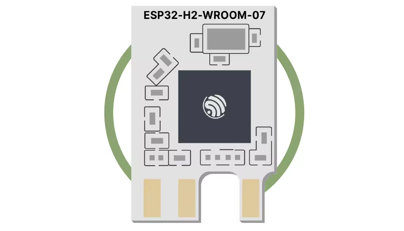

Espressif has recently introduced the ESP32-H2-WROOM-07, a compact Bluetooth Low Energy (BLE) and IEEE 802.15.4 combo module built around the ESP32-H2 series of SoCs. It features a RISC-V single-core 32-bit microprocessor running at up to 96 MHz, 128 KB of ROM, 320 KB of SRAM, 4 KB of low-power memory, and 2 MB or 4 MB SPI flash storage.
ESP32-H2 BLE module

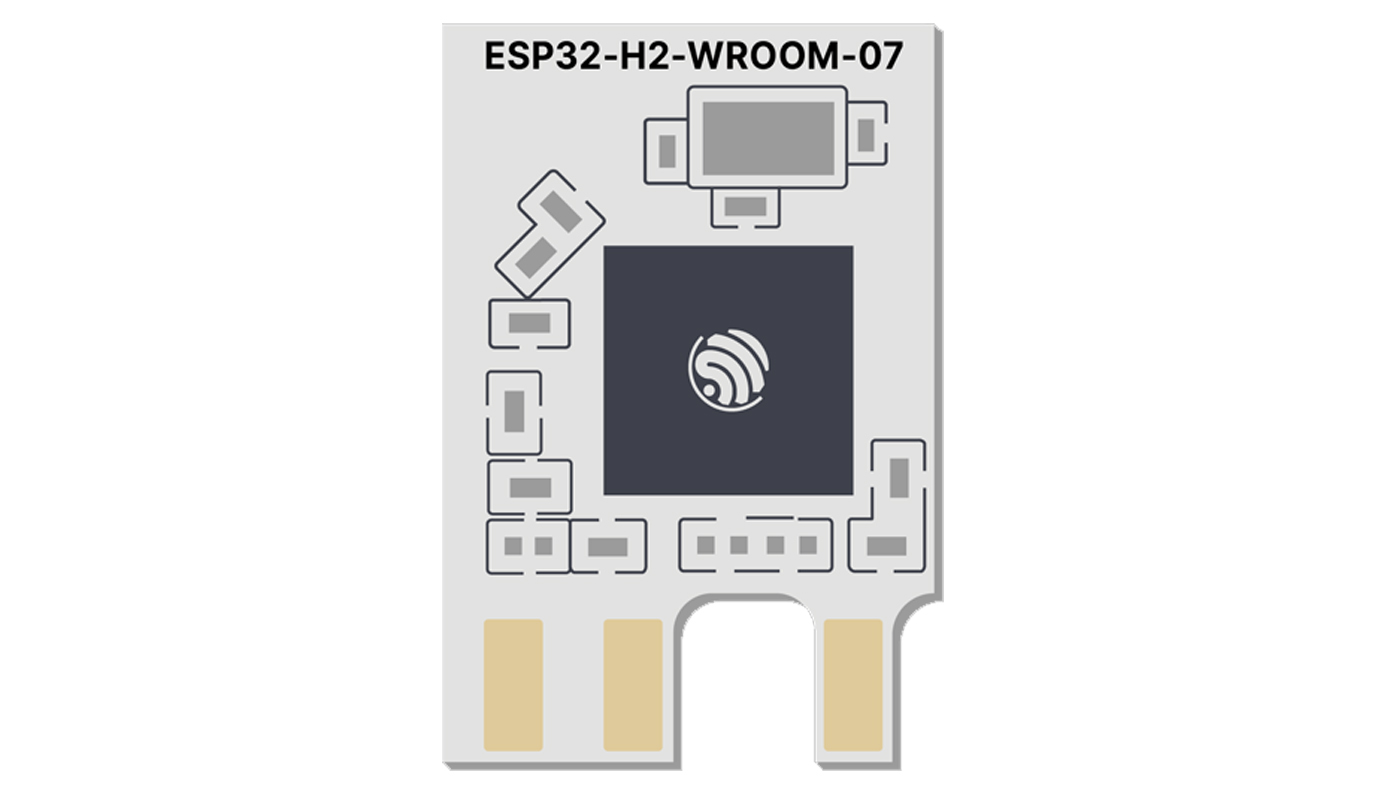

ESP32-H2 BLE module
This module is equipped with 3 GPIOs, various interfaces (I2C, SPI, UART, ADC, etc.), and a monopole antenna for wireless communication. Operating within a voltage range of 3.0–3.6 V and a temperature range of -40°C to 105°C, it is ideal for IoT applications such as smart homes, industrial automation, healthcare, and consumer electronics. The key features include support for BLE 5.3 with mesh networking, high-speed and long-range operation, and integrated peripherals for enhanced functionality. It is widely used in applications such as low-power sensor hubs, data logging devices, smart farming solutions, and robotic services.

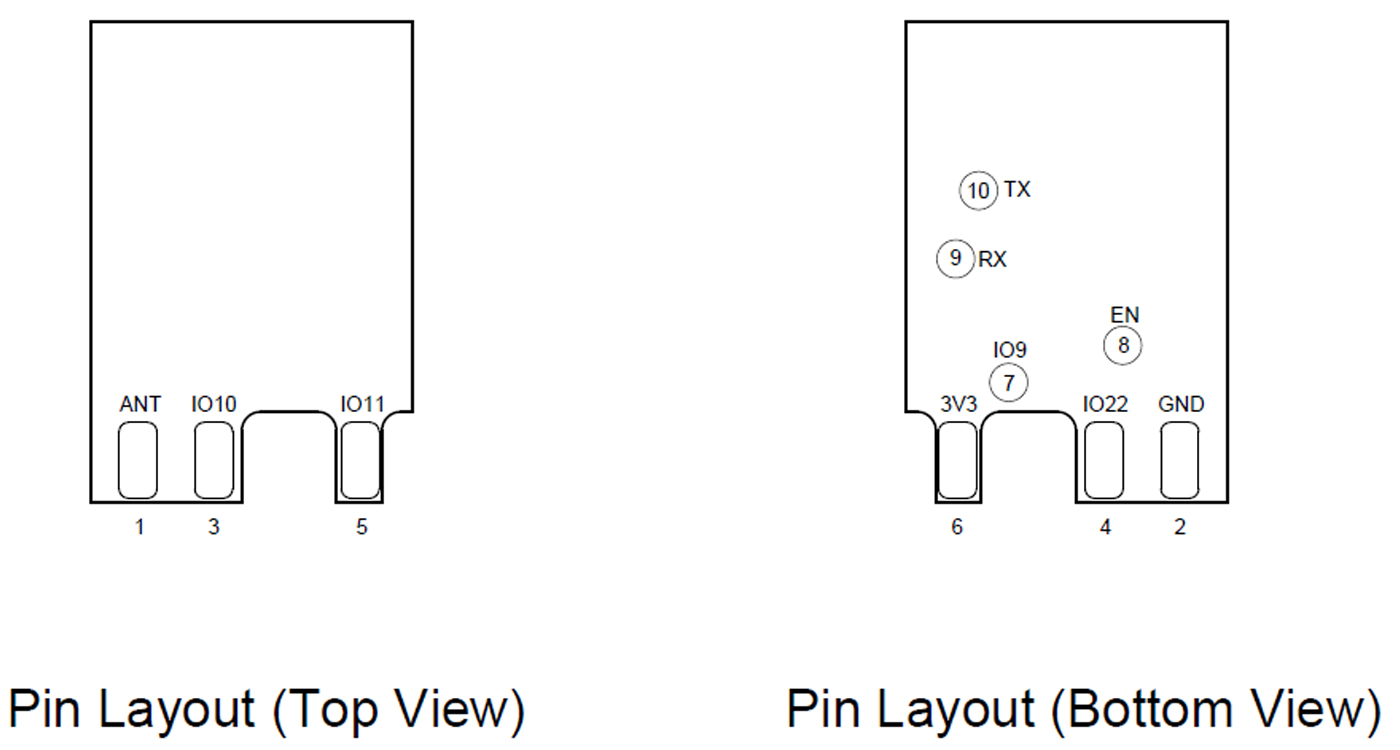

Measuring just 8.5 × 12.7 × 2.6 mm, the module complies with the IEEE 802.15.4-2015 standard, operating at a 250 Kbps data rate in the 2.4 GHz band. It also features three strapping pins that can be used as GPIOs, along with an integrated 32 MHz crystal oscillator. It supports advanced connectivity protocols like Thread 1.3, Zigbee 3.0, and Matter as well as other application-layer protocols such as HomeKit and MQTT.

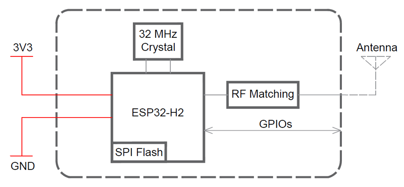

ESP32-H2-WROOM-07 Block Diagram

    • 3x GPIOs/3x strapping pins

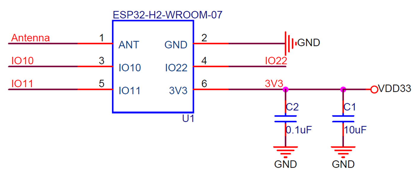

ESP32-H2-WROOM-07 Peripheral Schematics
