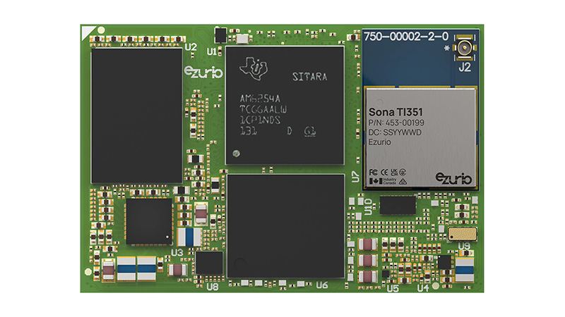

The Carbon AM62 OSM-MF from Ezurio is a compact industrial-grade System-on-Module (SoM) based on Texas Instruments AM62 family processors and combines application CPUs, microcontrollers, and deterministic real-time I/O hardware into a single 45 × 30 mm OSM form factor. The module is designed for embedded products that need both Linux application processing and real-time control.
industrial SoM
Carbon AM62 OSM-MF SOM (System-on-Module)
This board has a heterogeneous architecture, which is unlike most other SoMs based on Linux. The main operating system is executed by a quad-core Cortex-A53 with custom MCU cores and PRU (Programmable Real-Time Unit) responsible for time-sensitive tasks, including industrial I/O, motor control, or fieldbus timing. This enables application logic, user interface and hardware control to be run without latency concerns.

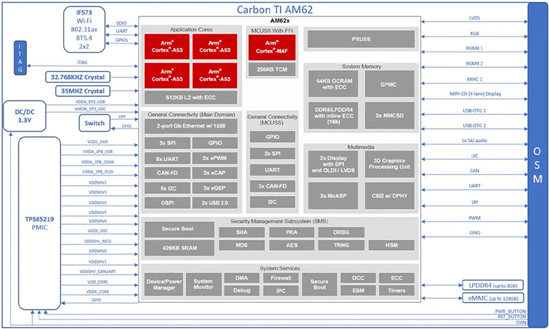

Carbon TI AM62 SoM Block diagram with Pin-out

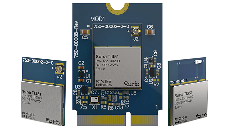

Sona TI351 – Wi-Fi 6 + Bluetooth v5.4 Module
