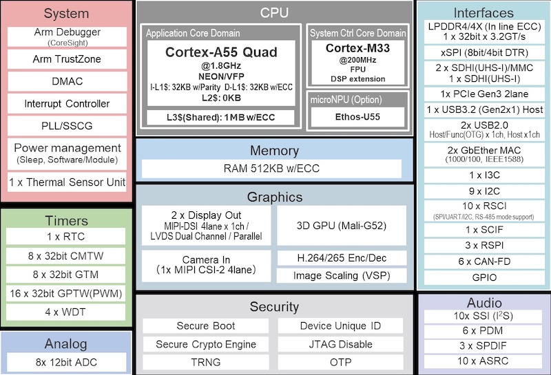

The RZ/G3E is built around a quad-core Arm Cortex-A55 CPU running at up to 1.8 GHz, complemented by a Cortex-M33 core for real-time processing tasks. For AI inference, the MPU integrates an Arm Ethos-U55 Neural Processing Unit (NPU), which is designed to handle AI-related workloads such as image classification, object recognition, and voice recognition, thereby freeing up the main CPU for other tasks.
Block diagram of the Renesas RZ/G3E MPU
Quad Cortex-A55 CPUs are at the heart of the new RZ/G3E. Image used courtesy of Renesas
It also features advanced graphics capabilities, supporting Full HD video at 60fps on two independent displays, and a variety of high-speed interfaces, including PCIe 3.0, USB 3.2 Gen2, and Gigabit Ethernet, to ensure seamless connectivity with cloud services and 5G modules. With its focus on performance, power efficiency, and a comprehensive software support package, the RZ/G3E provides a scalable and robust platform for developing next-generation HMI systems with advanced AI capabilities at the edge.
In terms of connectivity, the RZ/G3E is equipped with a range of high-speed interfaces essential for modern edge devices. These include two lanes of PCI Express 3.0, USB 3.2 Gen2 for data transfer up to 10 Gbps, and dual-channel Gigabit Ethernet for connectivity to cloud services and 5G modules.
Power management is another area of focus for the RZ/G3E. The MPU features advanced power management capabilities to reduce standby power consumption. It supports a DDR self-refresh mode to retain data in memory, allowing for a quick wake-up from a deep standby mode for running Linux applications. Renesas claims a standby power consumption of around 50mW and as low as 1mW in deep standby mode.
