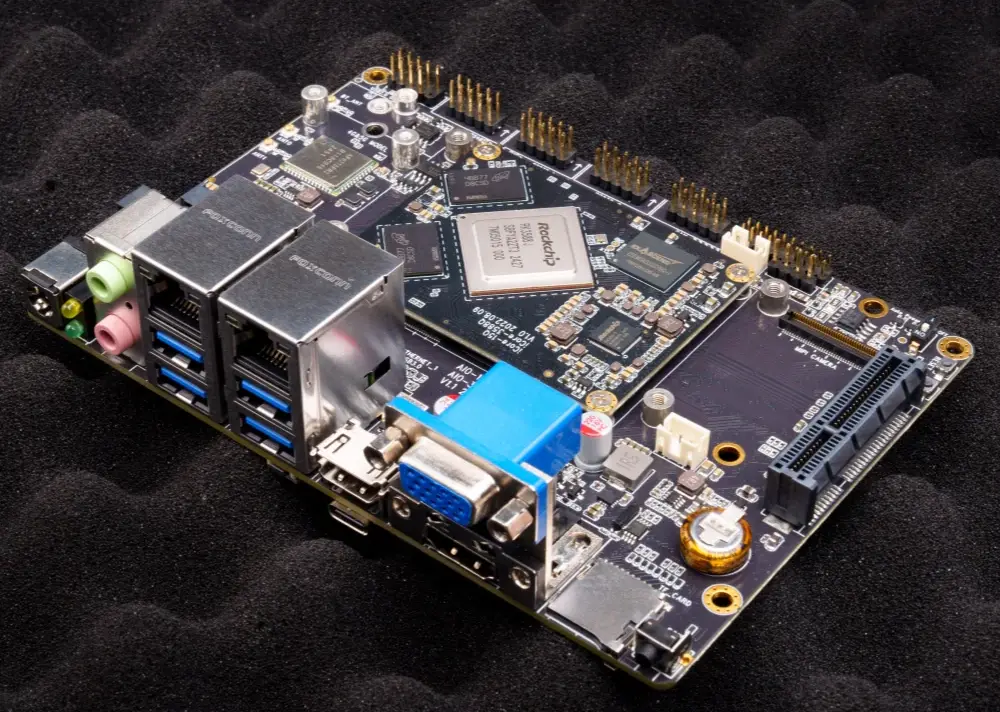

The AIO-3588Q AI ARM Motherboard uses the Rockchip RK3588 SoC to target edge computing, industrial control, and multi-display applications. It combines high-performance compute, AI acceleration, and rich I/O in a compact board. The design focuses on developers who need strong video processing, multiple display outputs, and flexible expansion without moving to x86 platforms.
Rockchip RK3588 integrates an octa-core CPU clocked up to 2.4GHz, paired with a Mali-G610 MP4 GPU and a 6 TOPS NPU. This setup enables local AI inference, video analytics, and edge processing workloads. The NPU supports INT4, INT8, and INT16 operations and works with frameworks like TensorFlow, PyTorch, MXNet, and Caffe, making it usable for real deployments instead of just demos.

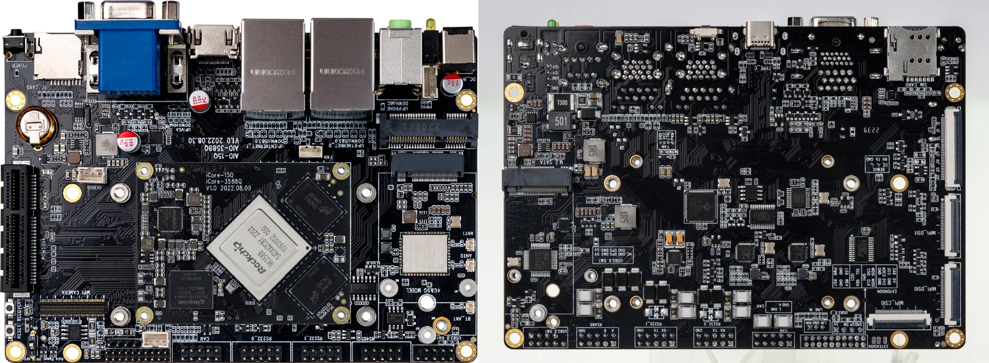

AIO-3588Q 8K AI ARM Motherboard Front and Back

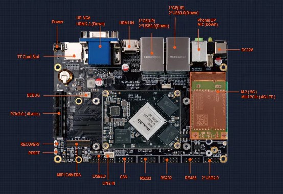

AIO-3588Q 8K AI ARM Motherboard Specifications:
  • SoC: Rockchip RK3588 octa-core processor (up to 2.4GHz)
  • GPU: ARM Mali-G610 MP4, supports OpenGL ES 3.2, OpenCL 2.2, Vulkan 1.1 (~450 GFLOPS)
  • NPU: Up to 6 TOPS (INT8), supports INT4/INT8/INT16 mixed operations
  • AI Frameworks: TensorFlow, PyTorch, MXNet, Caffe
  • VPU:
    • Decode: 8K@60fps (H.265/VP9/AVS2), 4K@60fps AV1
    • Encode: 8K@30fps (H.265/H.264)
  • Memory: LPDDR4/LPDDR4x/LPDDR5 (4GB / 8GB / 16GB / up to 32GB)
  • Storage: eMMC (16GB–128GB optional)
  • Expansion Storage: 1× M.2 SATA 3.0 (2242), 1× MicroSD (TF card)
  • Expansion: 1× PCIe 3.0 x4
  • Display Outputs:
    • 1× HDMI 2.1 (up to 8K@60fps / 4K@120fps)
    • 1× DisplayPort 1.4 via USB-C (up to 8K@30fps)
    • 1× VGA (1080p@60Hz)
    • 1× eDP 1.3 (up to 2K@60Hz)
    • 2× MIPI-DSI (up to 4K@60fps)
    • Supports up to six independent displays
  • Video Inputs:
    • 1× HDMI input (4K@60fps, HDCP 2.3)
    • 1× MIPI-CSI (configurable lanes)
    • 1× BTB connector (additional CSI/DSI expansion)
  • Networking:
    • 2× Gigabit Ethernet
    • Wi-Fi 6 (2.4GHz / 5GHz dual-band)
    • Bluetooth 5.0
    • Optional 5G / 4G via M.2
  • I/O Interfaces:
    • 2× RS232, 1× RS485
    • 1× CAN bus
    • 1× Debug interface
    • 20-pin header (GPIO, ADC, SPI, I2C, LED, reset, power)
  • USB:
    • 4× USB 3.1 Gen1
    • 3× USB 2.0 (headers)
    • 1× USB-C (OTG + DisplayPort 1.4)
  • Power:
    • Input: 12V DC input (±5%)
    • Power consumption: ~0.78W (idle), ~2.3W (normal), ~14.4W (max)
  • Dimensions: 146 × 102 × 37.5 mm
  • Operating Temperature: -20°C to 60°C
  • Humidity: 10%–90% RH (non-condensing)
