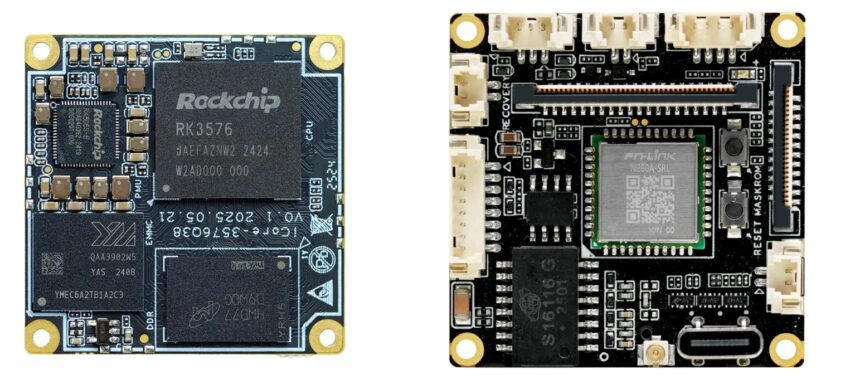

Firefly CAM-3576Q38 Mini AI SBC
For AIoT, edge AI, smart vision, industrial, and automotive applications, Firefly Technology has released the CAM-3576 series of mini (38 × 38 mm) SBCs based on the Rockchip RK3576 processor with a 6 TOPS NPU. The CAM-3576Q38 (commercial), CAM-3576JQ38 (industrial), and CAM-3576MQ38 (automotive) modules are available in three distinct configurations and are intended for use with dash cams, smart cameras, intelligent security systems, and private on-device AI model deployment. It incorporates a 6 TOPS computing NPU and has the Rockchip octa-core 64-bit AIoT processor RK3576, which enables the private deployment of popular large AI models and different deep learning frameworks. Additionally, it offers 4K@120fps high-definition, high-frame-rate display capabilities, 4K@60fps encoding, and 4K@120fps decoding.
Its 145G FLOPS Mali-G52 MC3 GPU allows for effective heterogeneous computing, satisfying the needs of graphics-intensive applications. Up to 16GB of LPDDR5 RAM, up to 256GB of eMMC flash, and a microSD card for expansion are all supported by the CAM-3576 series. The boards also have Fast Ethernet, Wi-Fi 6, USB 2.0, USB-C (device), RS-485, UART, I2C, ADC, GPIOs, audio input/output, RTC support, and a MIPI CSI input for up to 16MP camera sensors with HDR support.
Previously, Firefly introduced the ROC-RK3506J-CC industrial SBC and the ROC-RK3588S-PC credit-card-sized SBC. The CAM-3576Q38 is its first product based on the Rockchip RK3576 processor.

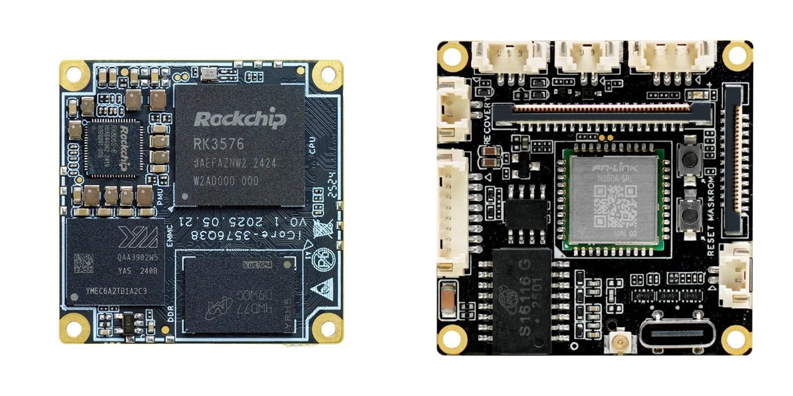

ICORE-3576Q38 SOM and CAM-3576Q38 Mini AI SBC

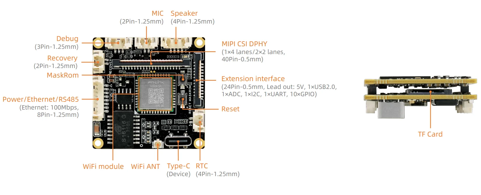

CAM-3576Q38 38mm Mini SBC Interfaces

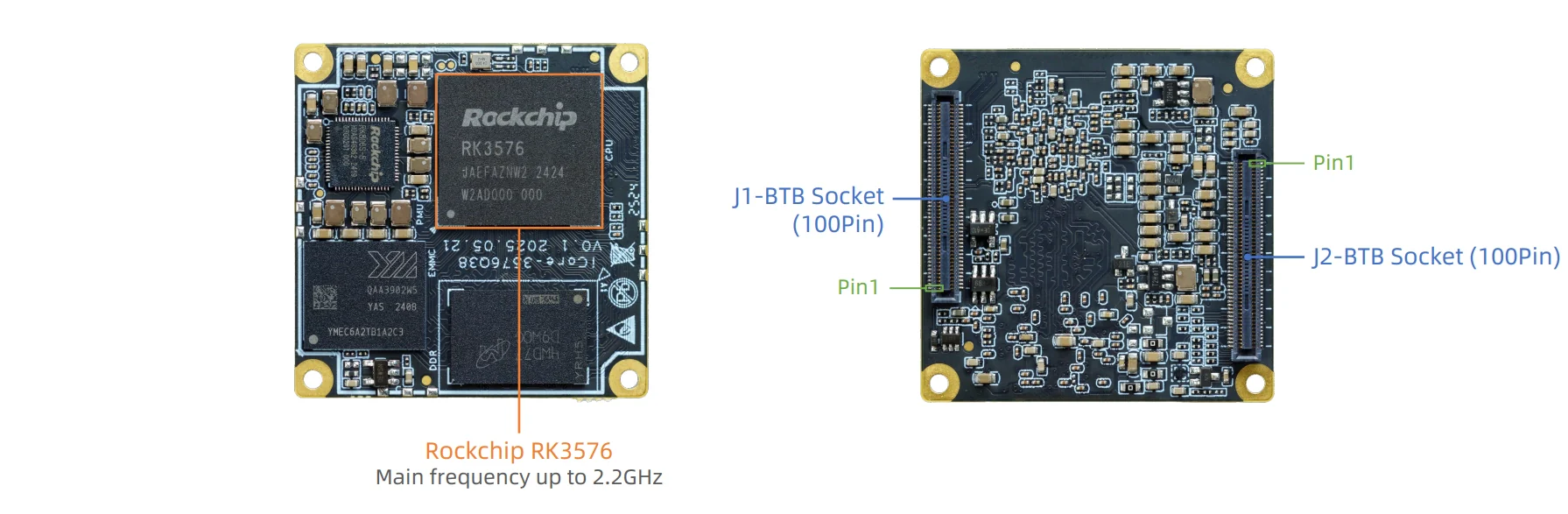

iCore-3576Q38 Industrial SOM
