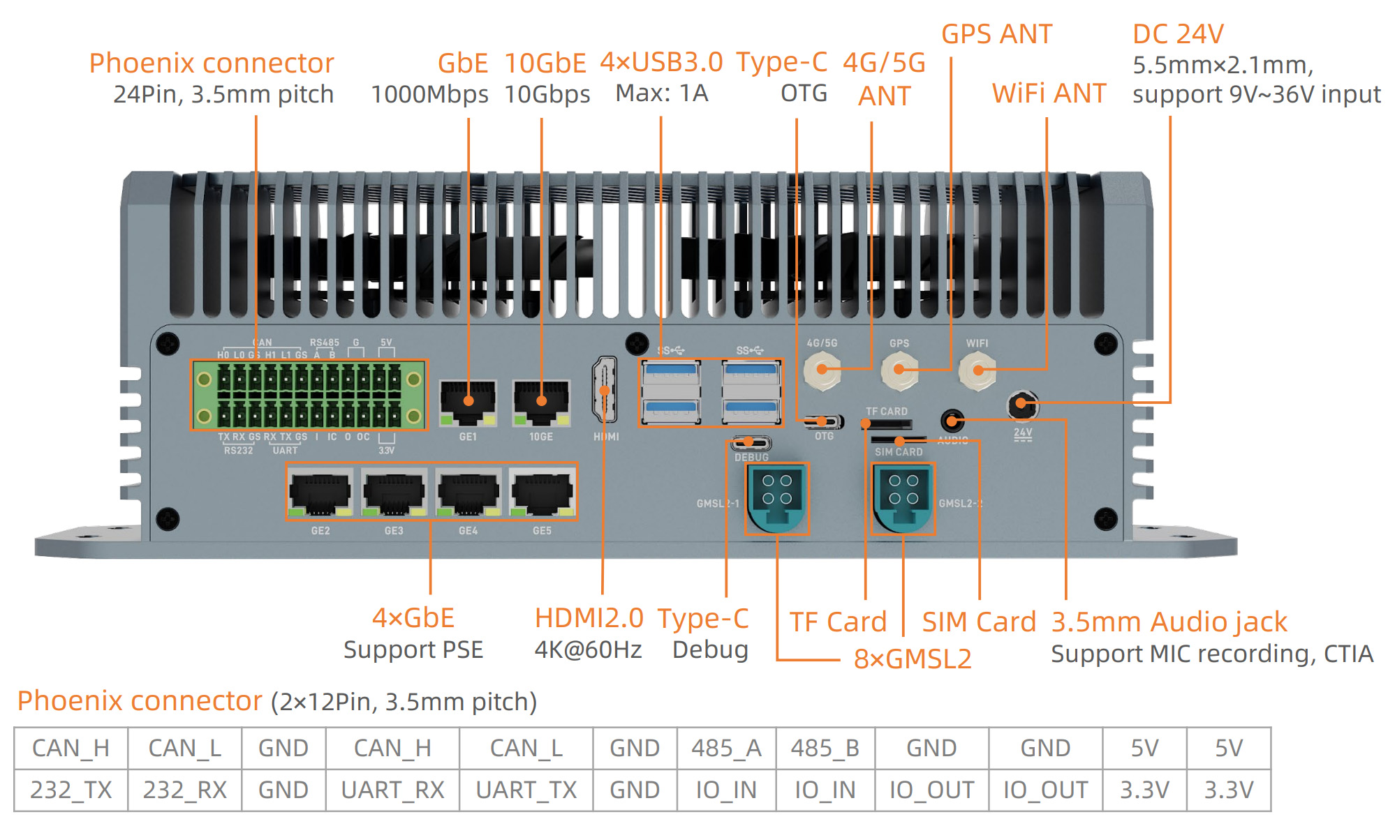

Firefly EC-AGXOrin hardware overview front side. Image used courtesy of Firefly

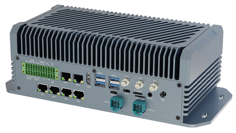

Firefly EC-AGXOrin hardware overview back side. Image used courtesy of Firefly

  • Camera: 8× GMSL2 via 2× Mini-FAKRA connectors
  • Networking:
    • 1× 10GbE RJ45 LAN ports
    • 5× GbE RJ45 LAN ports
    • Optional WiFi 6/Bluetooth via M.2 E-Key
    • Optional 4G LTE (Mini PCIe) / 5G (M.2 B-Key)
    • Optional GNSS
  • USB:
    • 4× USB 3.0 Type-A
    • 2× USB Type-C (debug + OTG)
  • Audio: 3.5mm jack with MIC support
  • Serial & I/O:
    • RS-232, RS-485
    • 2× CAN 2.0
    • UART, GPIO, 3.3V/5V pins
    • 8× DIO via DB-9

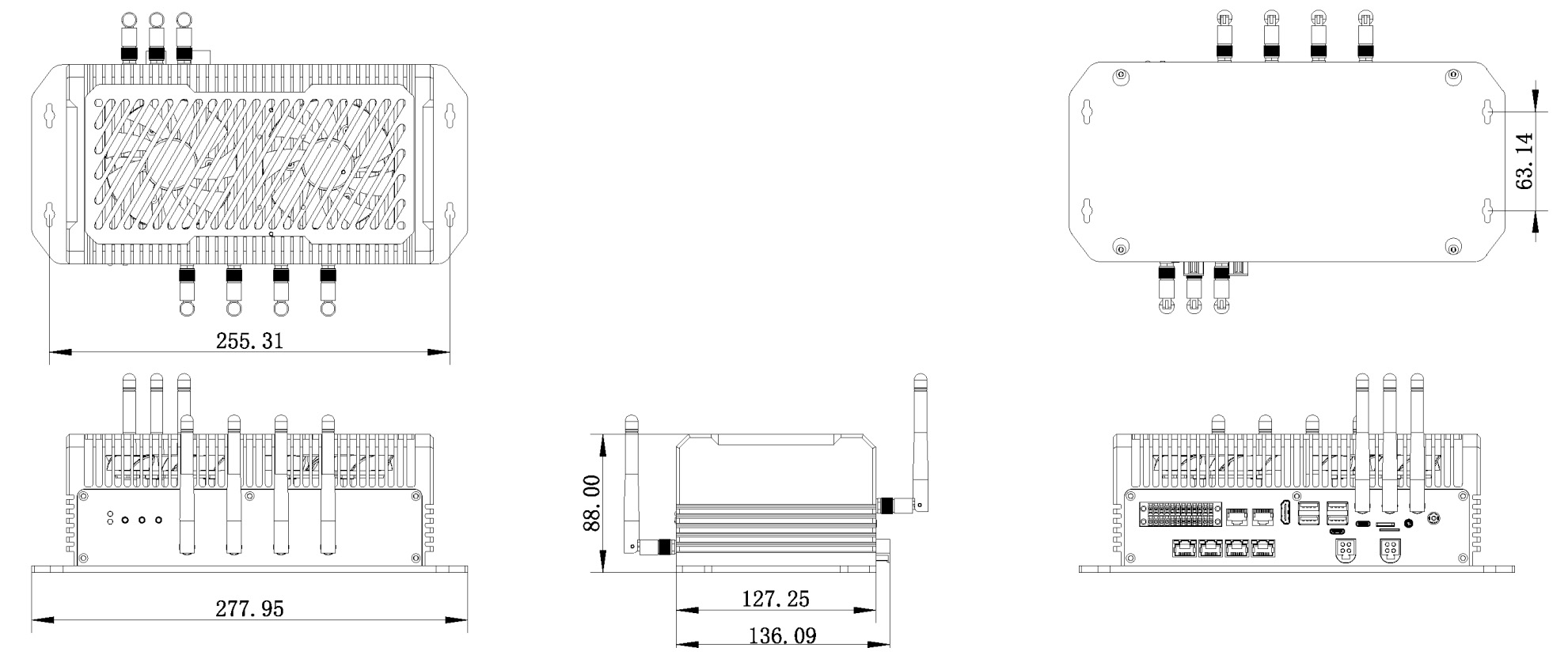

    • Dimensions: 277.95 × 136.09 × 88.0 mm
