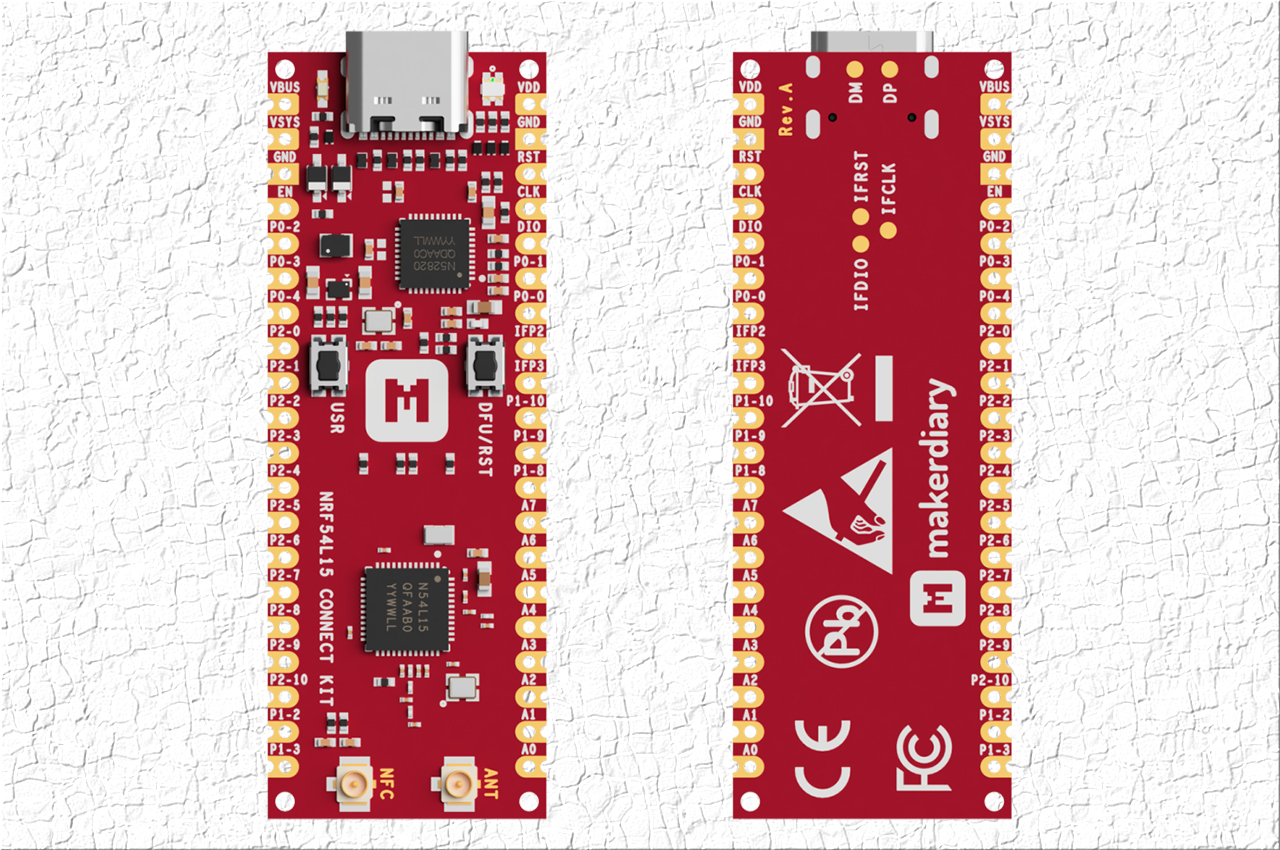

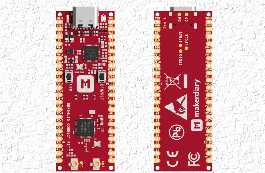

nRF54L15 Connect Kit - development board Front And Back Side
nRF54L15 Connect Kit – development board Front And Back Side

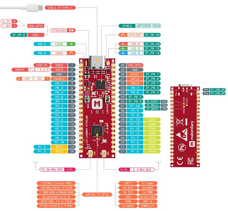

nRF54L15 Connect Kit - development board specifications
nRF54L15 Connect Kit – development board specifications

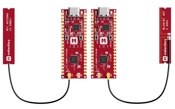

nRF54L15 Connect Kit with antenna
