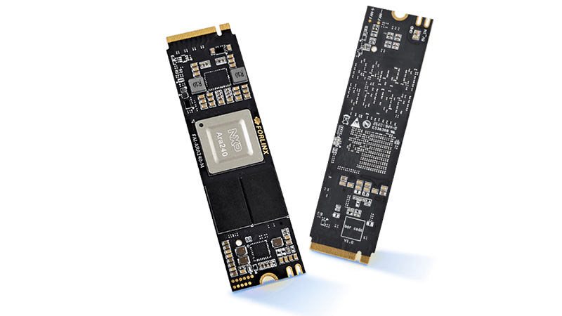

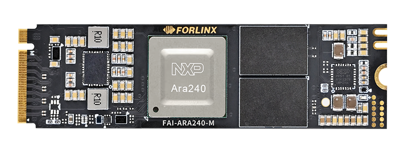

The FAI-ARA240-M is an M.2-based AI accelerator that uses the NXP Ara240 processor. Forlinx Embedded has officially launched it. With a dedicated NXP ARA-240 DNPU with 40 eTOPS and 16GB LPDDR4, it can handle bigger models and workloads with high throughput. It delivers an impressive 14 tokens/s for Llama2-7B via PCIe Gen4 x4, bringing server-grade intelligence to NXP-based industrial and embedded systems.
The module has a separate NPU that takes care of inference tasks that embedded host systems can’t handle. The module has a standard M.2 2280 shape with an M-Key interface. This means that it can be added to existing platforms through PCIe without needing to change the base hardware. It has PCIe Gen4 x4 and USB 3.2 Gen1 ports that let the host processor and the accelerator talk to each other.
FAI-ARA240-M Key Specifications:
  • Processor: NXP Ara240 DNPU Edge AI processor
  • AI Performance: Up to 40 eTOPS
  • Memory Options: 8GB or 16GB LPDDR4
  • Form Factor: M.2 2280 (M-Key standard)
  • Interfaces: PCIe Gen4 x4, USB 3.2 Gen1
  • Dimensions: 22mm x 80mm
