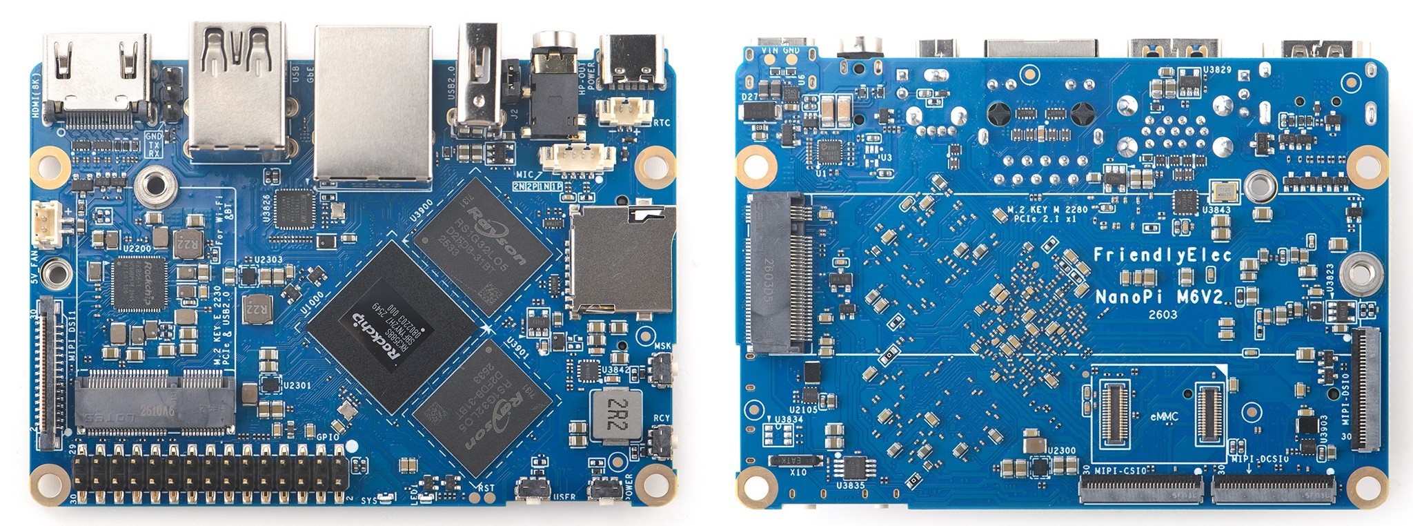

FriendlyELEC has introduced the NanoPi M6V2 RK3588S SBC, an updated version of its NanoPi M6 single-board computer built around the Rockchip RK3588S processor. While the board retains the compact 90 × 62 mm form factor and most of the hardware found on the original model, it introduces a new 4-pin connector that supports dual analog microphone input, making it more suitable for voice-processing and audio-focused applications.
The NanoPi M6V2 RK3588S SBC combines an octa-core Rockchip RK3588S processor with 8GB LPDDR5 memory, a 6 TOPS NPU, and support for multiple storage options including microSD, eMMC modules, and NVMe SSDs. The board targets edge AI, multimedia, light NAS, industrial automation, and embedded development projects while maintaining compatibility with a wide range of Linux and Android operating systems.

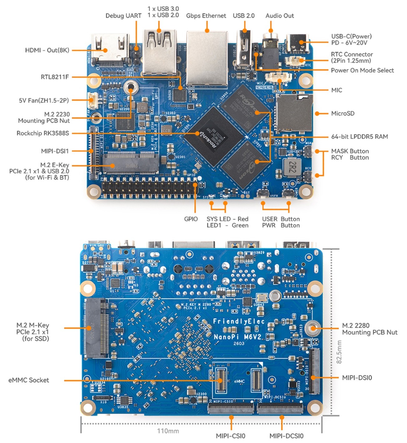

NanoPi M6V2 Top and Bottom Side

NanoPi M6V2 Specifications

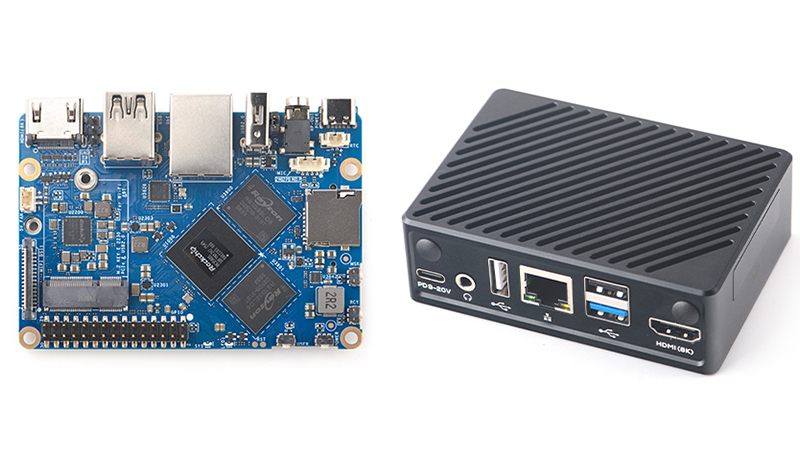

The NanoPi M6V2 RK3588S SBC is available from the FriendlyELEC store for $172 as a standalone board. Users can add an optional fanless metal enclosure for $15. Other accessories include an RTL8822CE Wi-Fi module for $6.90, a 4K MIPI camera module for $15, and eMMC storage modules ranging from $23 for 64GB to $61 for 256GB.
