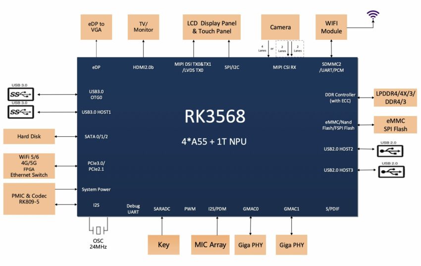

RK3568 Application Diagram
The Graperain G3568 single-board computer is equipped with a Gigabit Ethernet port, ensuring high-speed wired connectivity. It also supports dual-band Wi-Fi in accordance with 802.11a/b/g/n/ac standards and features Bluetooth 5.0 for seamless wireless peripheral connectivity. Designed to accommodate a range of operating systems, this SBC supports Android 11, Linux, Ubuntu, and Debian, offering versatility for various application needs.
