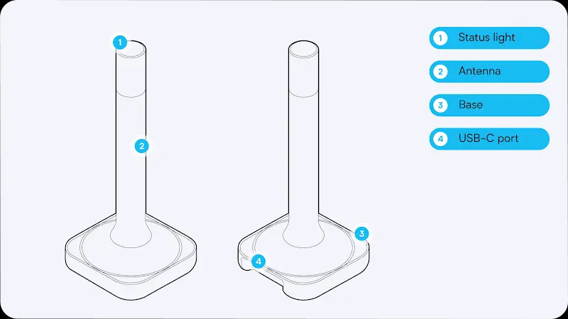

ZBT-2 Hardware Overview. Images used courtesy of seeedstudio
Home Assistant Connect ZBT-2 Specifications
  • Wireless SoC: Silicon Labs MG24 (Arm Cortex-M33 @ 78MHz, DSP, FPU, 256KB RAM, 1.5MB flash)
  • Bridge MCU: ESP32-S3 (WiFi/Bluetooth disabled in firmware)
  • Wireless Support: Zigbee 3.0, Thread, Matter (single-protocol operation)
  • Tx Power: 10 dBm (EU), 8 dBm (rest of world)
  • Antenna: 2.4 GHz omnidirectional, 4.16 dBi peak gain
  • Baud Rate: 460,800 bps for improved responsiveness
  • Host Interface: USB-C
  • Button: Z-Wave-style function button
  • Power: 5V/0.5A via USB-C

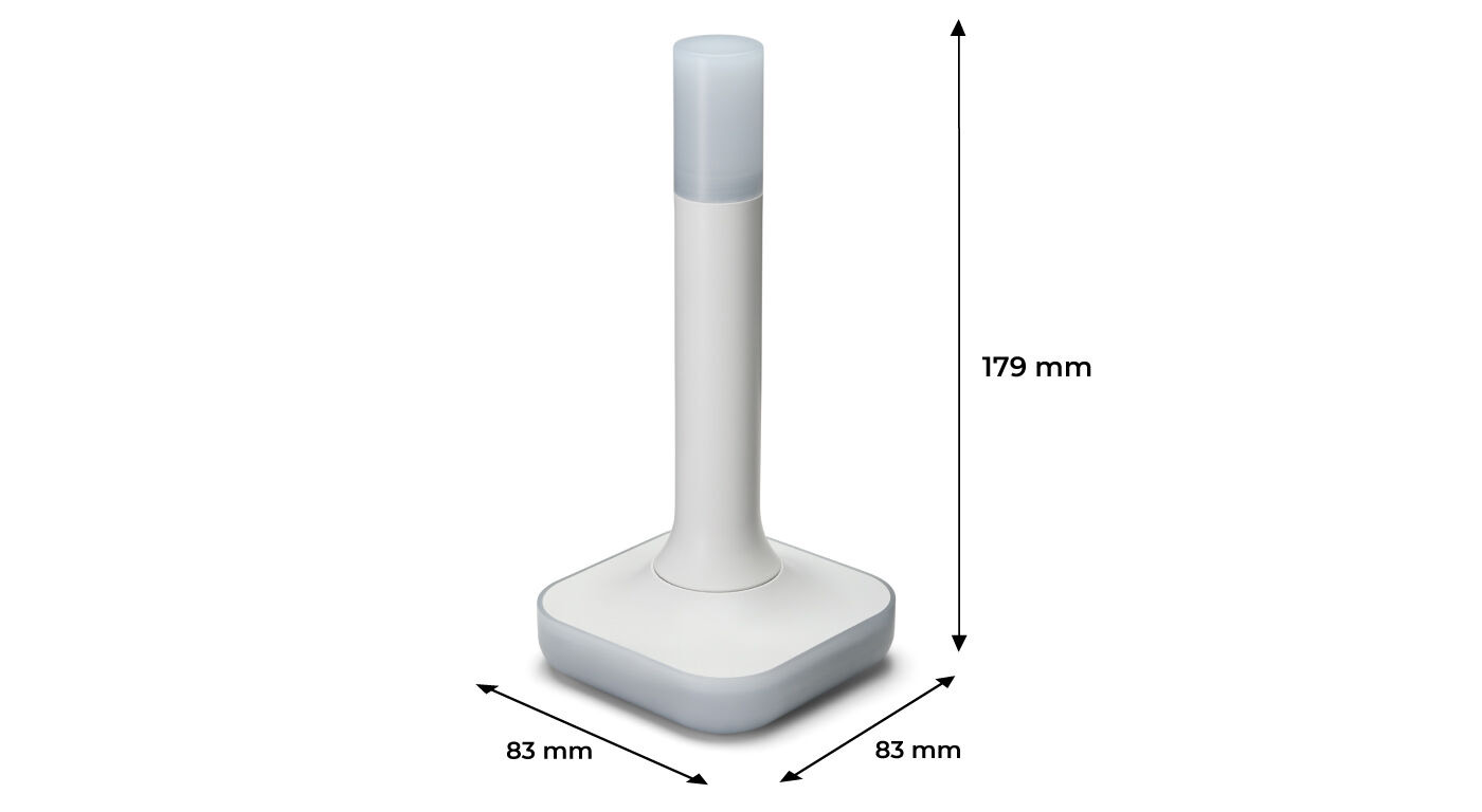

  • Dimensions: 176 × 83 × 83 mm (polycarbonate enclosure)
  • Weight: 157 g
  • Operating Conditions: 0–65°C, dry indoor environments
  • Certifications: CE, FCC, RCM (FCC ID: 2A8ZE04)

ZBT-2 Dimensions. Images used courtesy of seeedstudio
