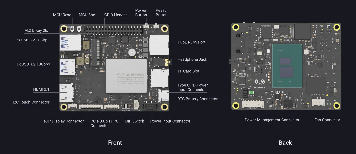

LattePanda IOTA Hardware Overview

LattePanda IOTA supports Windows 10/11 and Ubuntu 22.04/24.04, with full driver and firmware support for the Intel N150 and RP2040 subsystems. Developers can access GPIO, I²C, and UART through SDKs and APIs, with configurable BIOS, TPM 2.0 security, and firmware tools provided by DFRobot.

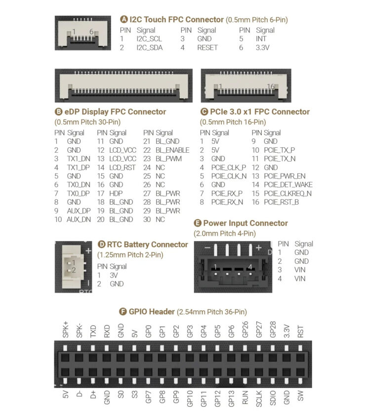

LattePanda IOTA’s Connectors and Pinout Diagram
DFRobot provides multiple add-on boards such as M.2 SSD, PoE, UPS, and LTE modules, making the LattePanda IOTA suitable for embedded AI systems, IoT gateways, and compact industrial PCs.
